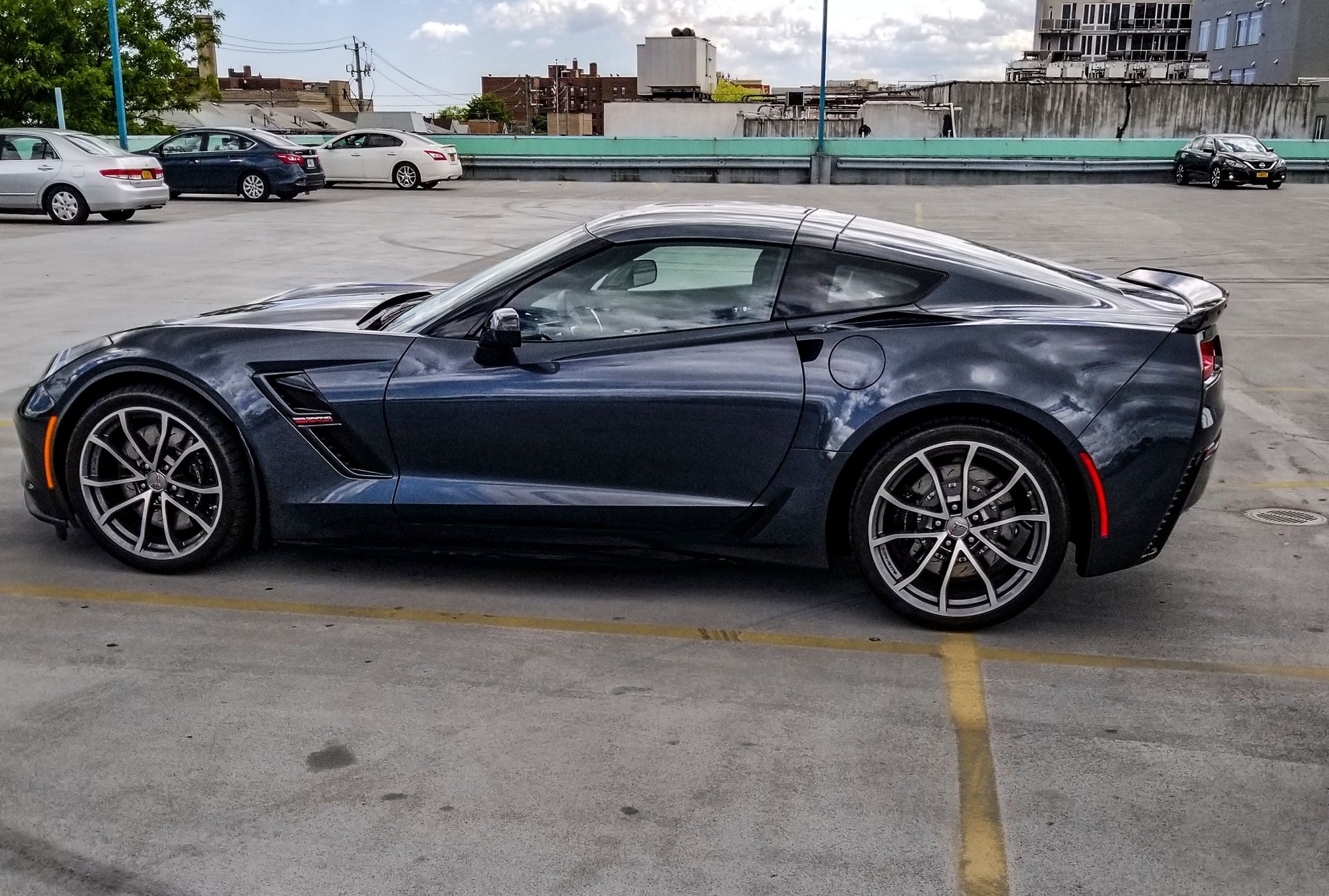

My 2019 Grand Sport come with summer only michelin track tiers I am so not a track person. With this being said I was thinking about swapping them out for the Michelin all weather Pilot Sport A/S 3+. Ive heard that they were a lot quieter give better gas milage and provide a smoother "touring" ride. Any advice would be helpfull

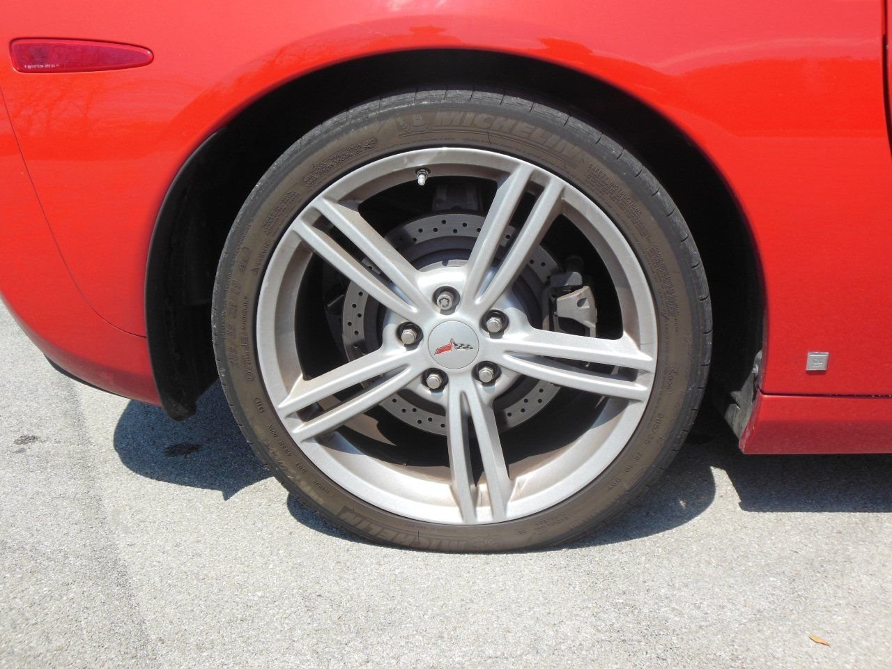

Originally Posted by TxLefty
My guess is that it would be easier to access the underside of the car with an airless run flat tire than with an airless non-run flat. My understand is that the rules for repairing run flats are not as liberal as non-run flats, so that is probably why they have to be replaced more often. You are correct that it's a good idea to consider all your options. There are disadvantages to run flat tires. The advantages become obvious when you are miles from help with an airless tire.
You can barely tell if a runflat is flat by looking at it, so getting under the car should be much easier. Here's a pic of the flat right-rear runflat on our C6. The car had a big trunk full of luggage, almost full gas, and my wife siting in the passenger seat when the picture was taken.
I am not aware that runflats get replaced more often, but it it's true, I suspect the reason is that people keep driving on the flat until it's convenient to stop, instead of stopping right now like you need to do with a standard tire.
