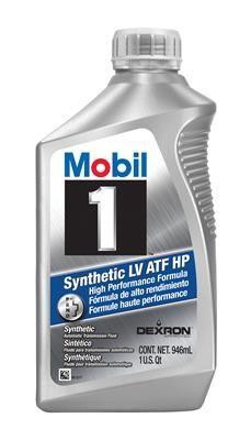

I'm assuming from your post that you have not gotten a fluid flush. Go to your trusted dealer, tell them you are experiencing a shudder. Per the latest TSB, nothing else needs to be verified. You will get the latest fluid, which is the Mobil1 LV ATF HP, blue label bottle. I have not heard a single issue with the latest fluid (unless of course the damage is already done). Do it as soon as you can

Correct. Build dates after 2/1/19 Do not require the new fluid since they come with the newest fluid.
Here’s the fluid your dealership should be using
