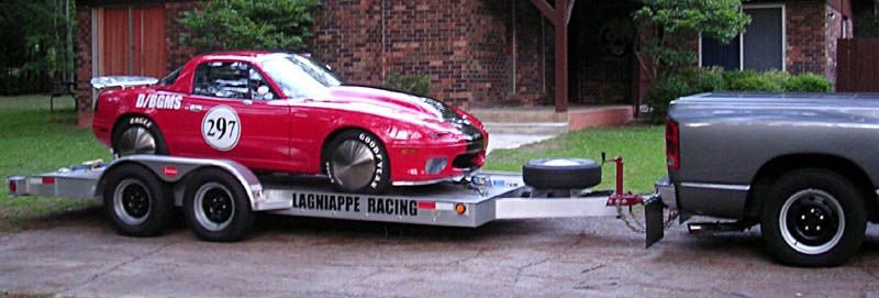

I have a 16' aluminum trailer I've used for quite a few performance cars. Doors have never been an issue with any, including my C5, with the trailer fenders removed. My C7's not been on it, but it's not significantly different from the C5, except less low front overhang.
Anyway, here's how I load and unload. I connect the trailer and truck, then raise the front of the trailer quite a bit. Then, I use the 6' aluminum trailer ramps from the trailer onto the first section of my Race Ramps. Viola! On and off it goes. If in doubt, remove the Vette, under-nose, side air-deflectors. All the best!
(I thought I had a pic of the C5 on the trailer, but not so. But, here you can see by my wife's B'ville racer that with the trailer fenders removed there would be no clearance problem)
