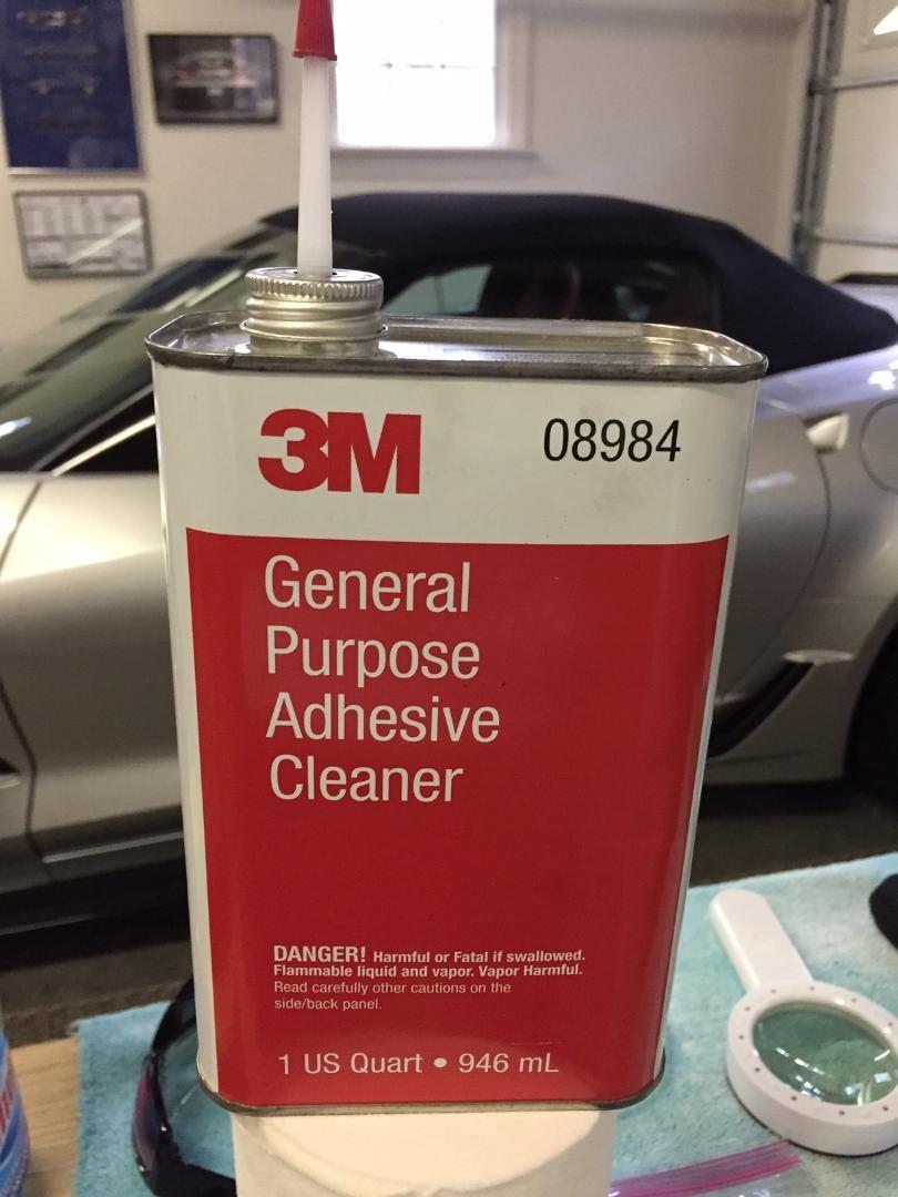

That's why I'm perfectly happy with the old school approach. As far as cleaner for this type mess 3M 08984 works great as well and rubber/vinyl friendly.
