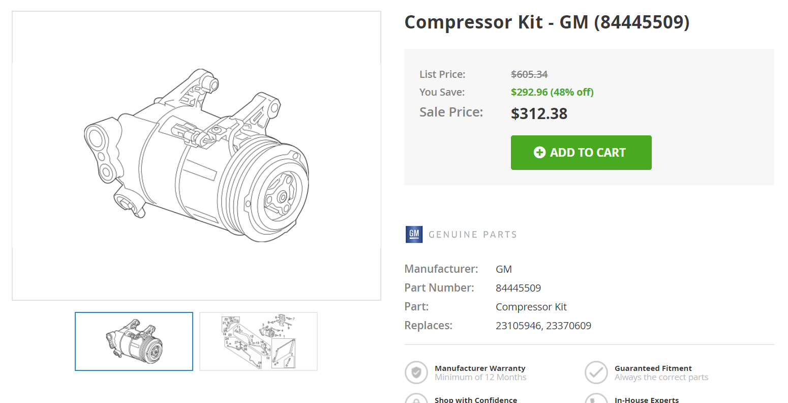

Definitely get some help from GM. 3600miles/4yrs is unacceptable for any part of the car. The alternative is doing it yourself (or a buddy). I found the compressor - now just need some HVAC knowledgeable folks (or videos). Good luck.
