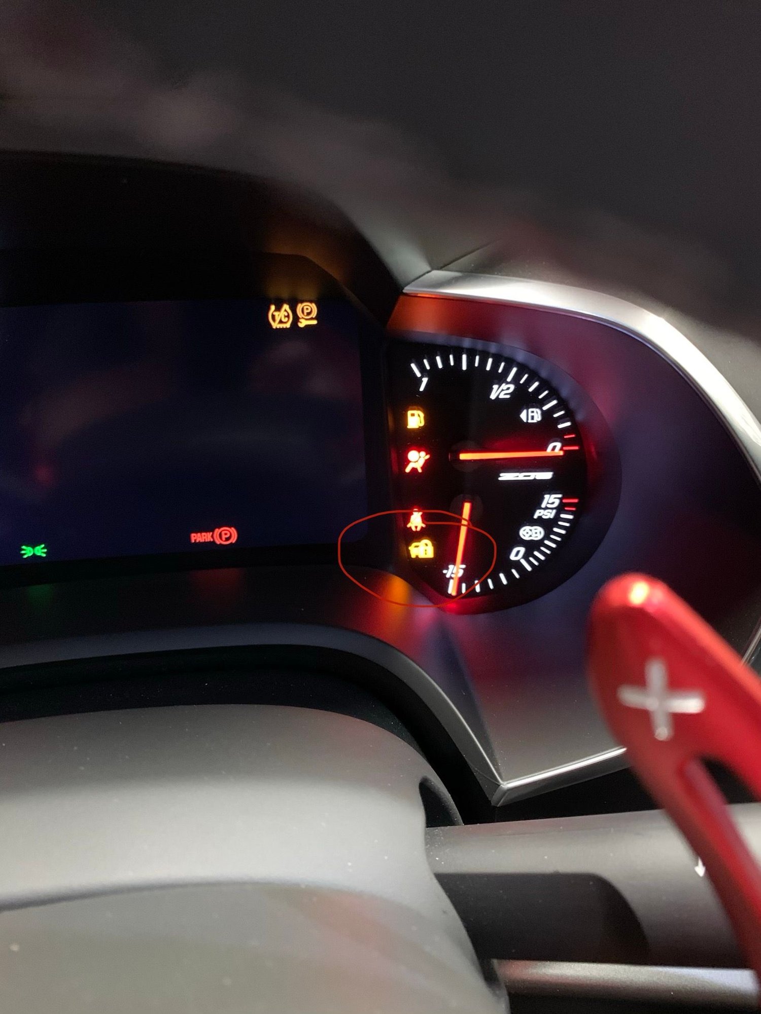

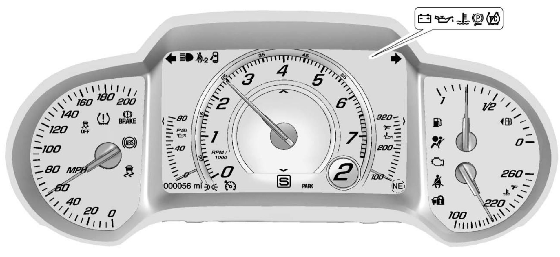

“The dash light”? Which light shown in the picture below was it?

I went out and checked mine. The only “car” icon I see is the one I circled. Is this what you’re asking about?

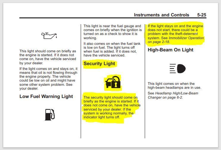

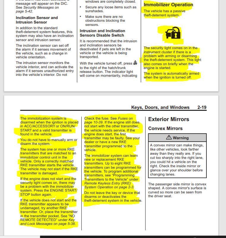

Security Light / Immobilizer Operation?
