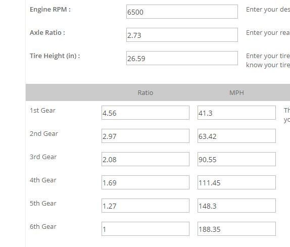

According to the chart below, our 2017 Z51 A8 would hit the rev limiter in 6th at 188 mph, so you could call that electronically limited.
But in 7th or 8th, the redline speed would be much higher but you couldn't make enough HP to get there.
My understanding is that there is no actual mph speed limit programmed into the car.
Somewhere I read that the tires are rated for "over 186" but can't confirm that.

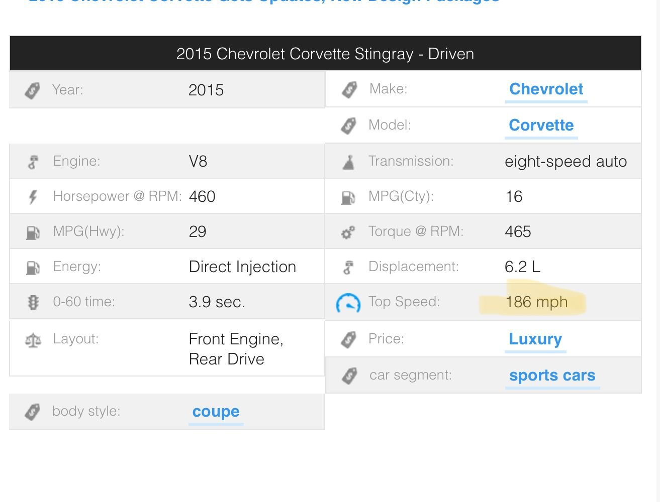

This was a driven speed for a '15 Ray (from TopSpeed.com)
