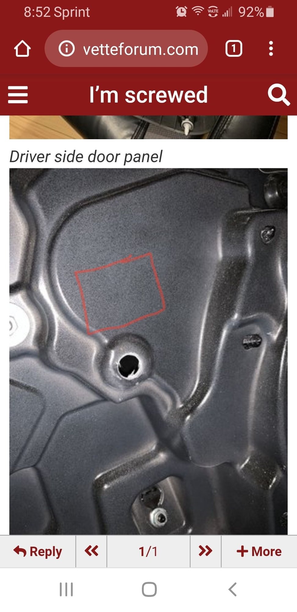

I知 screwed

Just cut an access above epoxy a nut to a plate and then the door and reinstall..

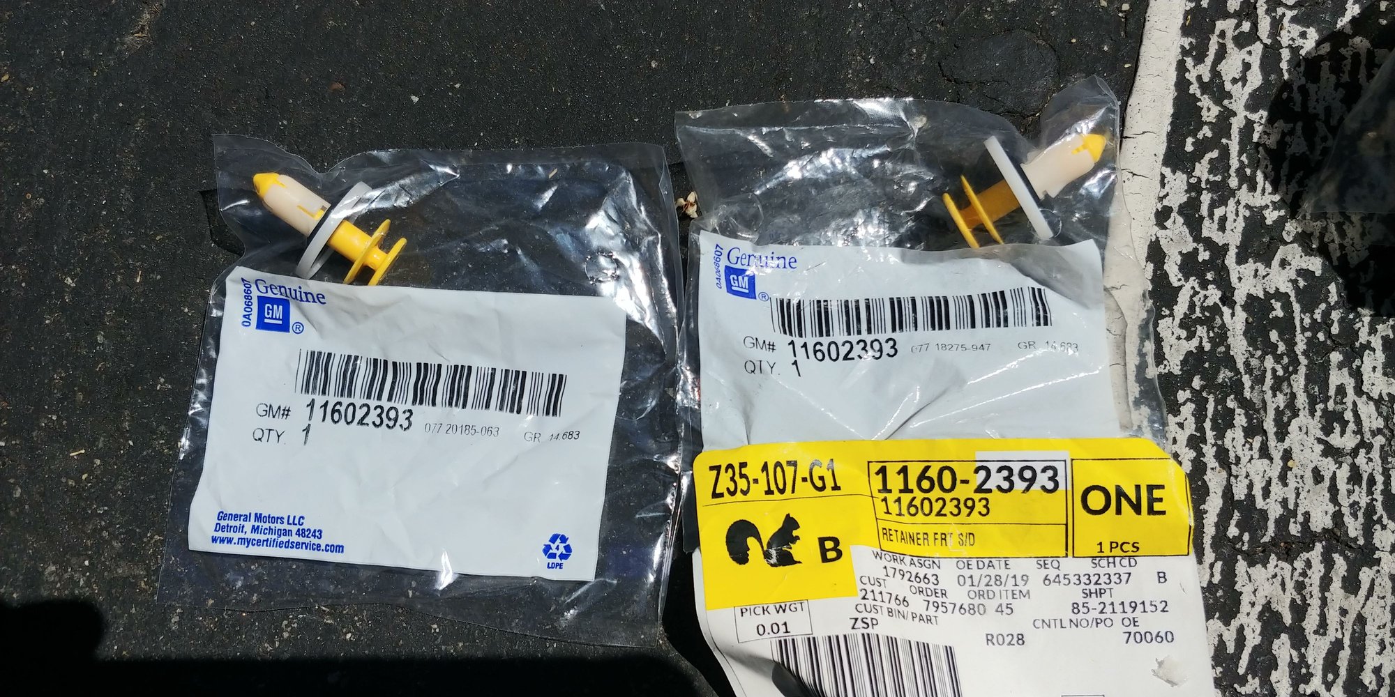

You might need these.. =)

A wellnut would do the job, small enough in diameter to go through the hole (and back out if desired) without falling off of its bolt and into the door.
