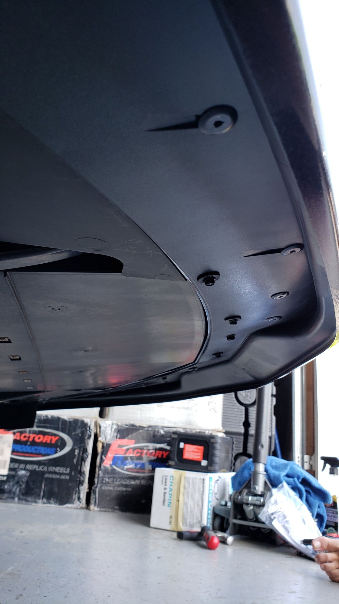

Rivets and screws are needed. I got my front splitter off Amazon and it came with all the rivets I needed, I just reused the screws holding my stock one... It will look like this when your done:

Those rivets, do you have to drill the heads off to remove them?
Old Aug 29, 2020 | 07:36 PM
Mayor111's Avatar
Mayor111
Joined: Oct 2016
Posts: 3,340
Likes: 2,084
From: Lehigh Valley PA
Yes - I drilled most of them out with a small drill bit. Some started to spin as I got into the rivet...so I just used a very thin flathead screwdriver and tapped it sideways with a hammer till it snapped the head off.
