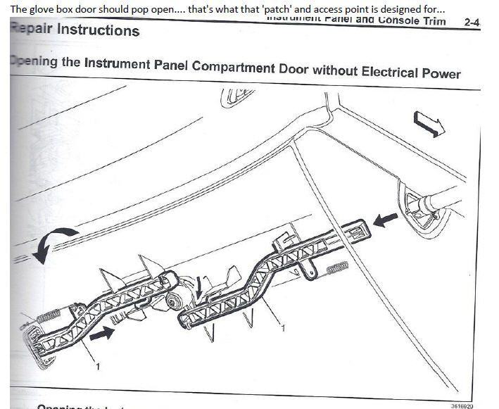

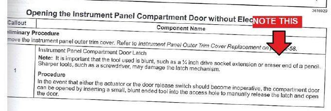

Old Oct 3, 2020 | 04:11 PM
RonC7's Avatar
RonC7
Joined: Dec 2012
Posts: 3,858
Likes: 1,865
From: St. Louis Metro East IL
Default Glove Box Latch Defeat
I saved this from an old thread. Hope it helps...
If the electronic latch on the glove box is not releasing the glove box door, try the following: Open the passanger side door look on the right side of the glove box area now exposed by opening the passenger side door for a small (about 1 inch square) access patch Pry open the access patch Push a long rod (an 1/4 inch socket tool extension work well) into the access hole and push against the locking mechanism.
Ron
