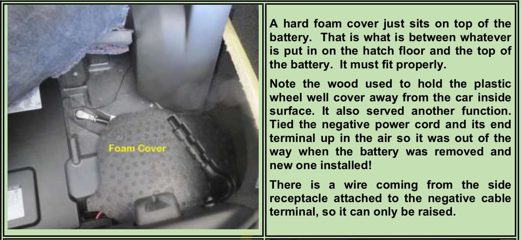

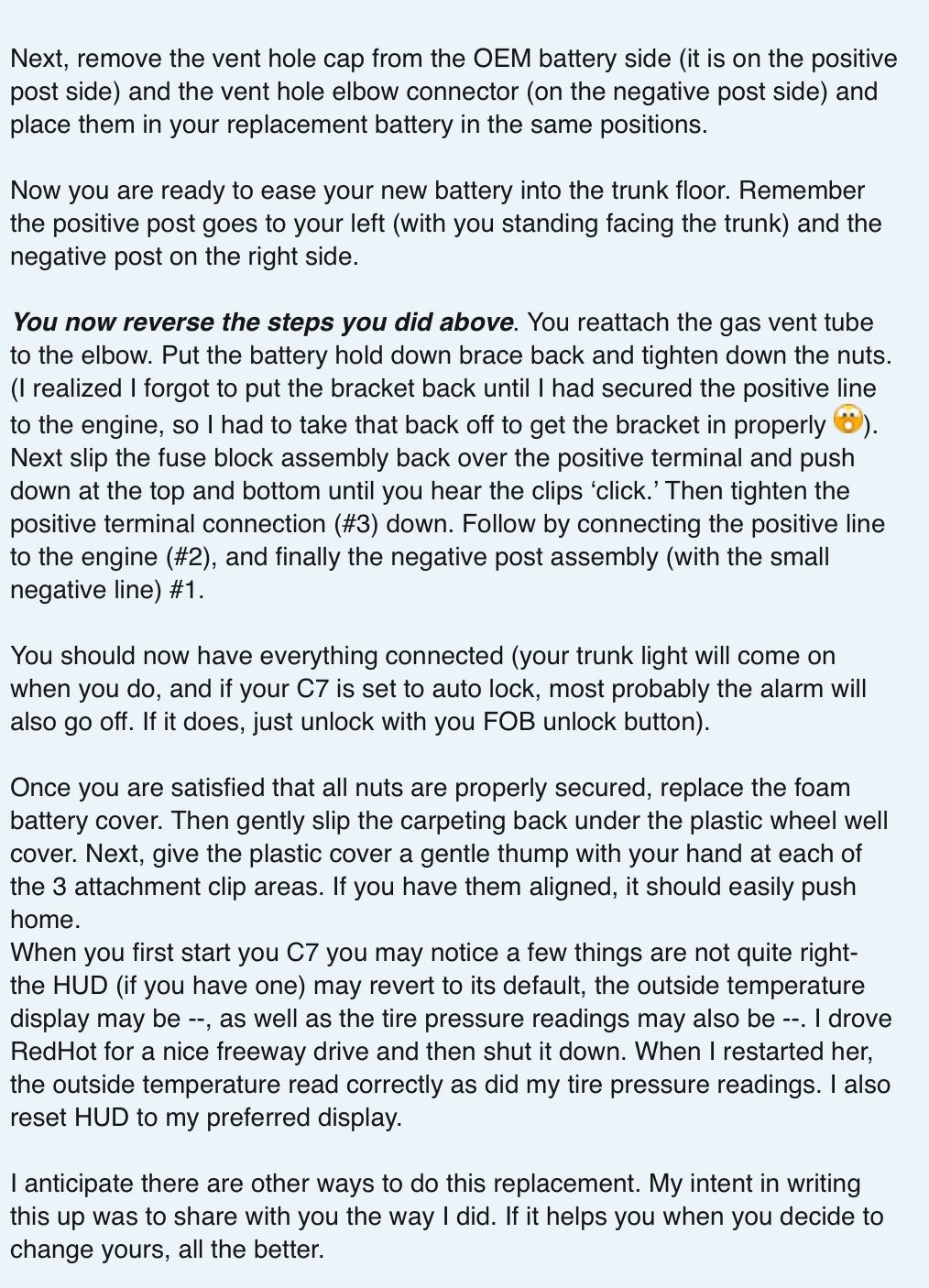

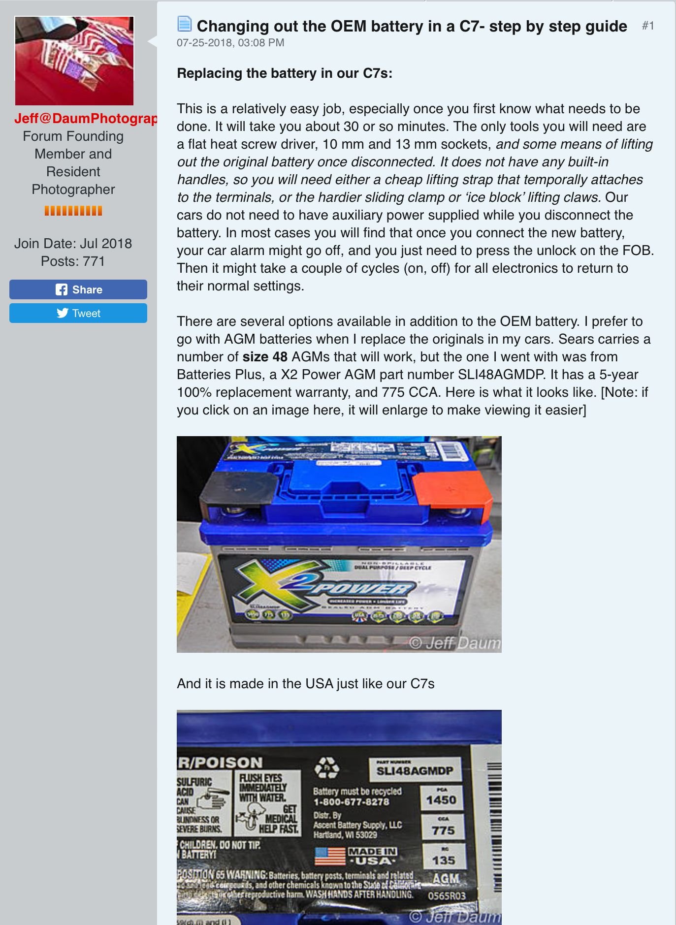

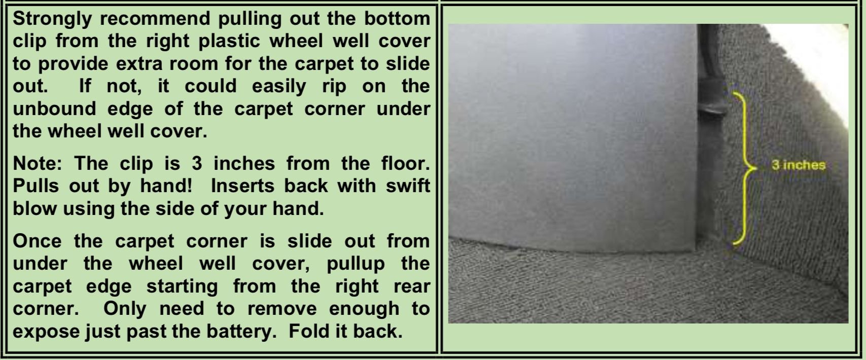

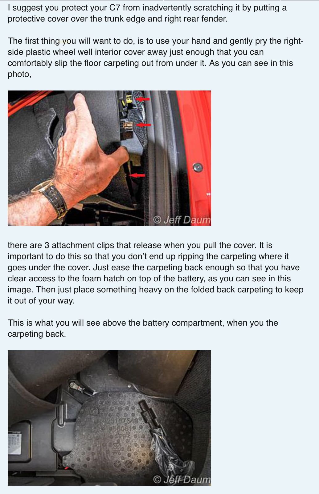

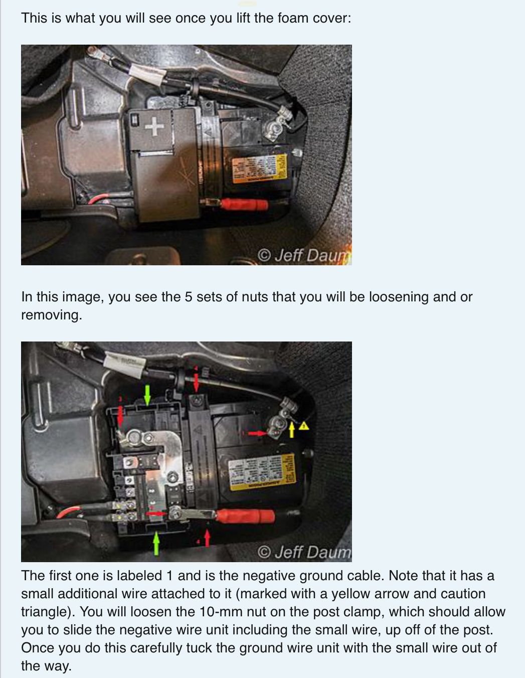

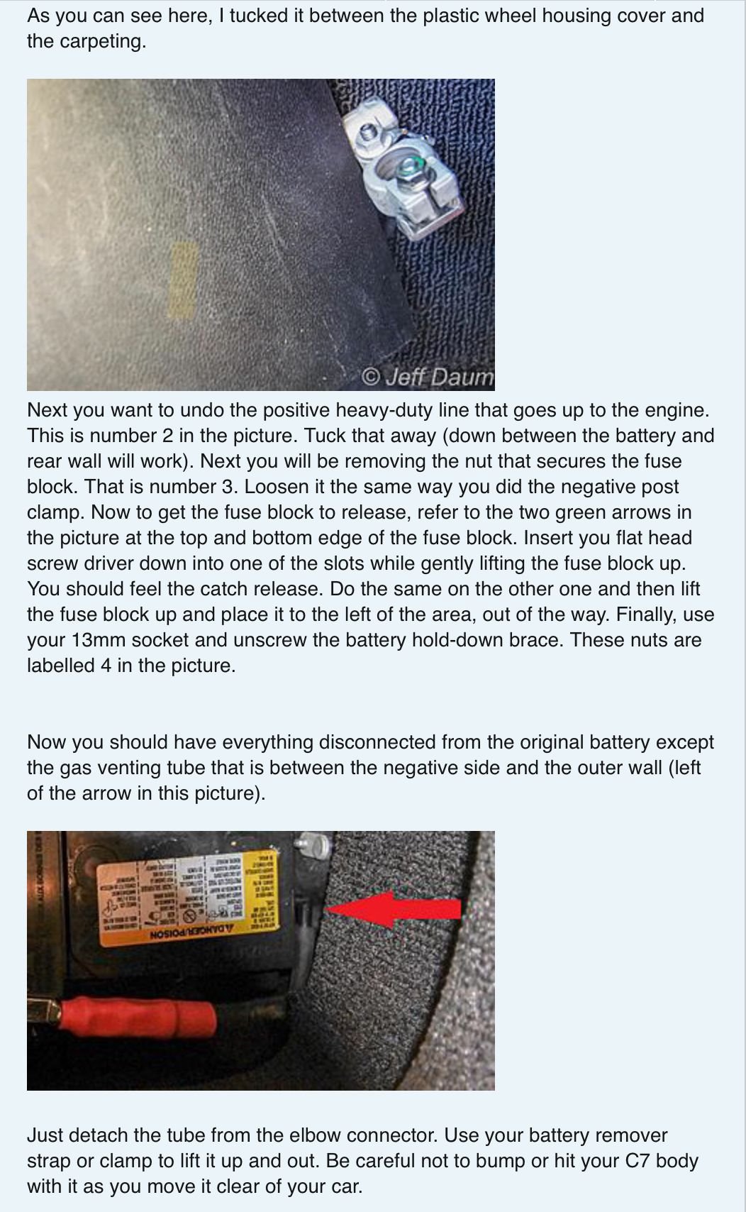

Believe these pics (to prevent damaging your hatch floor carpet) came from Jerry U:

Post 6 video is a good one. However, videographer doesn't discuss the carpet issue. In fact you can see his carpet has been previously damaged. Additionally take a look at the photos I just posted. Here is another instruction to consider.

The correct procedure is to push the carpet from the edge instead of pulling it away. This prevents the sharp edges of the plastic wheel well molding from cutting into it. It's not really that difficult, and yes it could have been better designed. I also would have liked a flip up lid for the battery, similar to the storage area on the driver's side.
Regardless, simply push the carpeting form the side out from underneath the plastic molding and then roll it back and out the way. That's how you also access the rear fuse box.
