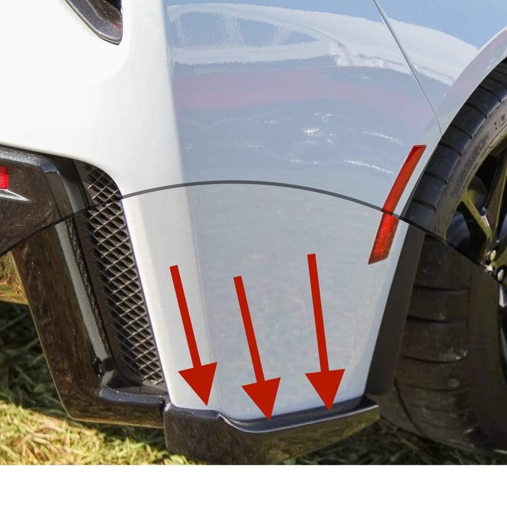

Backed into something (obviously)
2016 and first mark on her smh

Go to sleep, try to buff it out or use touch-up paint the next day. It's a Corvette, built to last, you'll be ok.

its down to the plastic
Will have to try touch up paint I guess just never seems to work

It's in an inconspicuous spot, have a beer and relax. We have seen far worse.

That would bother me too. Here's what I do with blemishes. I rub spit on it (or water) to see if the metallic shows. If it does, you need DuPont clear to cover the marks. The clear will hide it and bring it back up to level. If you don't see the metallic show through spit or water you will need a touch up. You can try it yourself with oem touchup or run it by your local Chevy dealer and have them look at it. It doesn't loook like that can be "rubbed" or "buffed" out with an orbital but you could try a microfiber cloth with 3M glaze or a polish to see if you can most of it out, for the time being.

Why not try the repair yourself first? He may be able to get most of that out by rubbing it out with a glaze or polish. Everyone is so scared to work on their own cars. It's ridiculous.

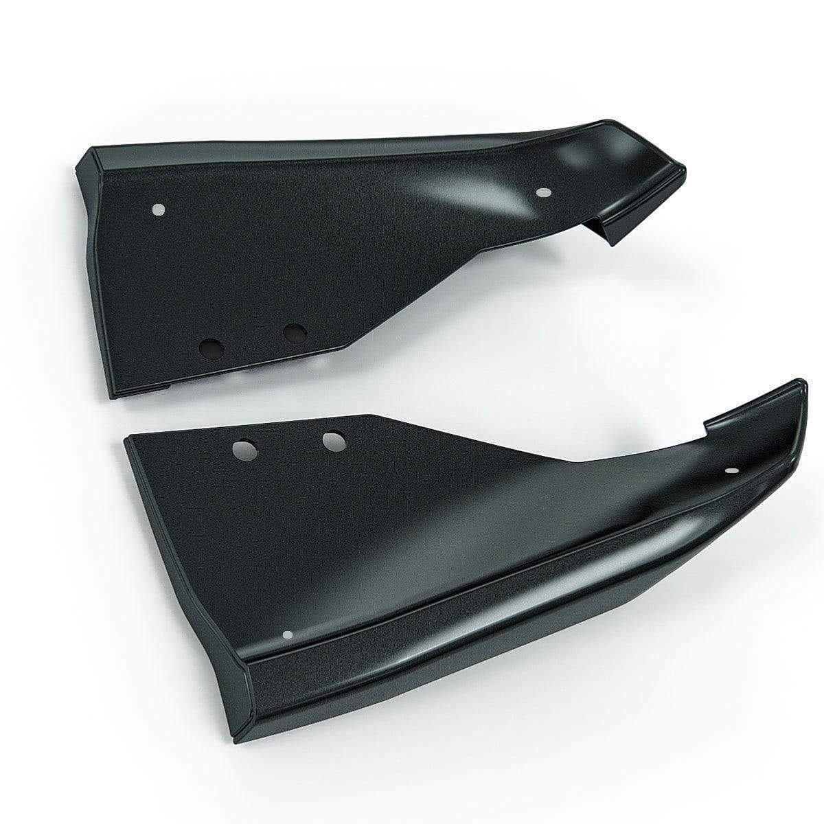

I think these will cover and make the rear look nicer.

Something in this picture doesn't look right ???
At first I said the same. I think what you are seeing is a photo with and insert included. The insert is a very slightly zoomed photo of the original. That's my take.
