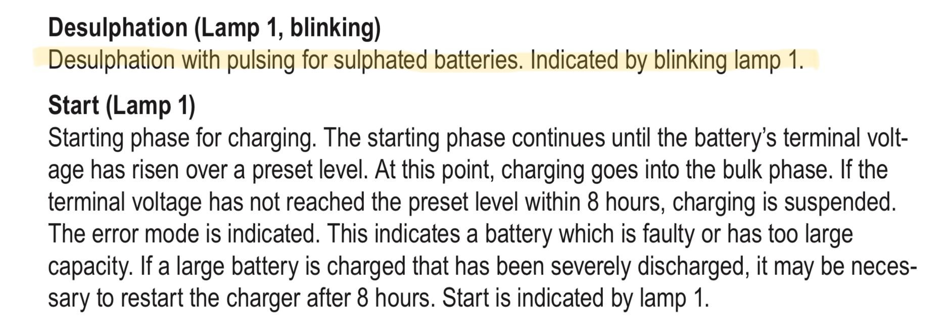

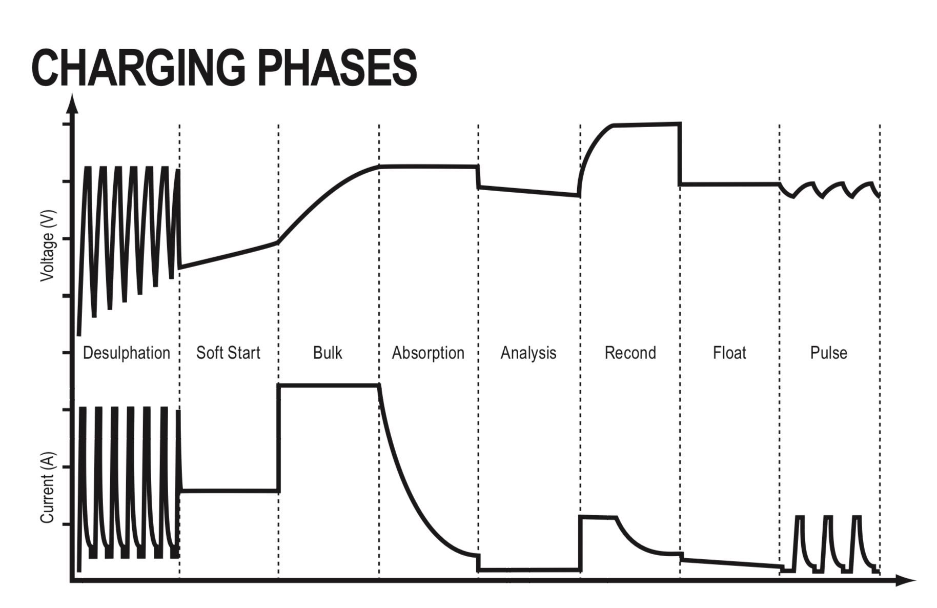

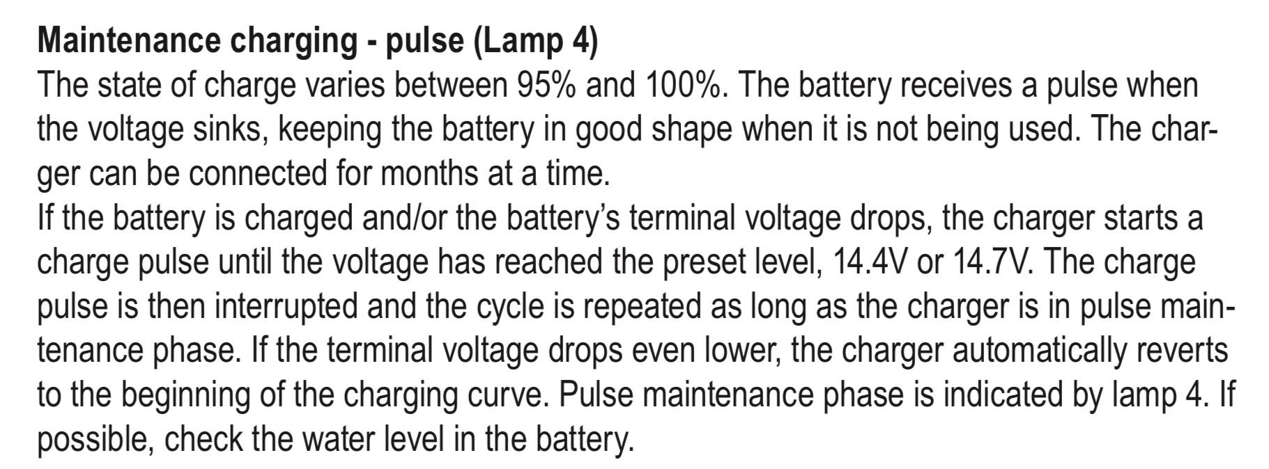

Your mechanic is not as smart as you think he is. The are only 2 phases where the CTEK will pulse. It will pulse if it determines that the battery is sulfated. Light #1 will blink if it performing desulfation your battery. The CTEK will only perform this step if it is needed. It is by design and one of the many reasons why this charger is so good. The other instance is when the charger is in maintenance mode. These small pulses keep the battery at 95-100% of the battery's full charge capability. There is nothing wrong with your CTEK charger. The CTEK has overheating protection your NOKO doesn't. It also has reverse polarity protection. If your need surge protection go to Costco and purchase a power strip. CTEK chargers will never surge your vehicle's electronics. They're the best charger/maintainers on the planet. I have been using CTEK chargers for years. All the world's top performance/luxury auto makers all use and sell CTEK chargers with their vehicles. Ferrari, Bentley, BMW, Porsche,.....
