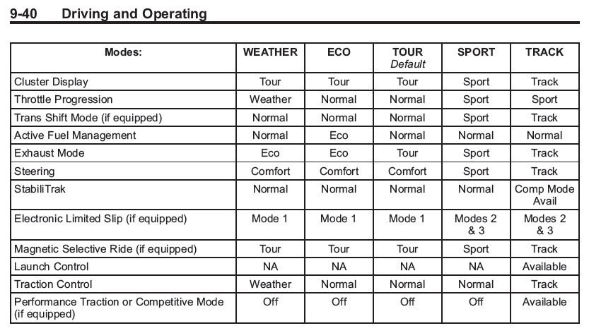

Originally Posted by keegs54
im confused.so m r c is different than the sport track tour modes that are on every corvette c7
If you don't have the magnetic shocks then changing driving modes (via the center console selector) only effects the steering resistance, throttle mapping and (if equipped) the exhaust sound among other things. See below...
Now if you have a Z51 (which adds the eLSD) along with MRC that also unlocks the PTM (performance traction management) which allows various levels of traction control for track driving situations.
Mag-ride is major game changer to me... totally worth the cost. Other manufactures have licensed the tech from GM, for example Ferrari, Audi, Ford, Acura and Lamborghini all offer mag-ride options now
