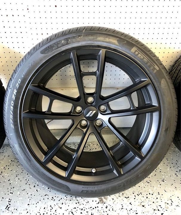

Saw someone local was selling their "20” OEM Dodge Charger Forged Daytona Hellcat SRT Scat Pack Wheels" and am just curious if they would be an option for a C7 GS? With all of the "cracked wheel" issues, I assume that I would have read about someone doing it already if it was a viable option.
They are listed as 20x9.5” ET 18.5mm 5x115 so even if they are compatible, they wouldn't be staggered sizes like the original GS wheels.

Won’t fit. All C7 wheels use a 5 x 120.65mm bolt pattern.

Your going to need adapter and they are dangerous to say the least. Walk away and buy something else

yeah sorry this is a terrible idea
here is a smokin deal on forged
https://www.corvetteforum.com/forums...debody-c7.html
another option is C6 Cup wheels, they were well made, no issues
https://www.corvetteforum.com/forums...up-wheels.html
watch the classifieds on here, good things come up
'flow-formed' or 'rotary forged' wheel sets are available around $1500 iirc and are quite good as well.

Wise choice since they won't just bolt on.
