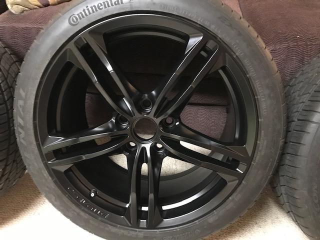

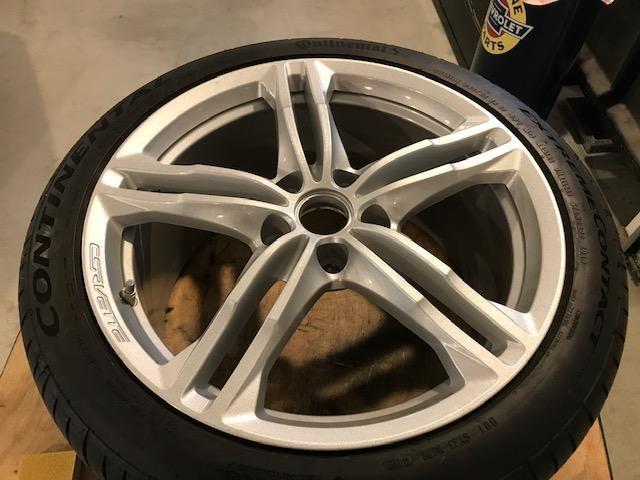

well I resprayed
my own ,they were a silver color ,and sprayed them a black satin ,,if for some reason they dont hold up then I will get them power coated ,I have about $25 into them doing it myself!!

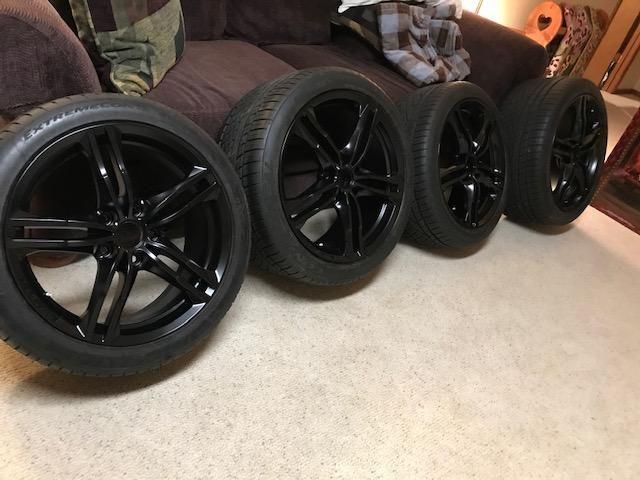

i got them on my car today!

well I have $25 into mine and my labor ,im retired so I dont have anything else to do ,but take a nap!!
