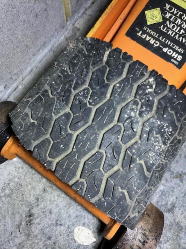

Great video and safety reminder, Thanks
Just a recommendation, as opposed to using a block of wood between jackstands and placement point, I use a piece of rubber tire as less chance of slippage and don't have to worry about an old piece of wood possibly splitting out on you.
