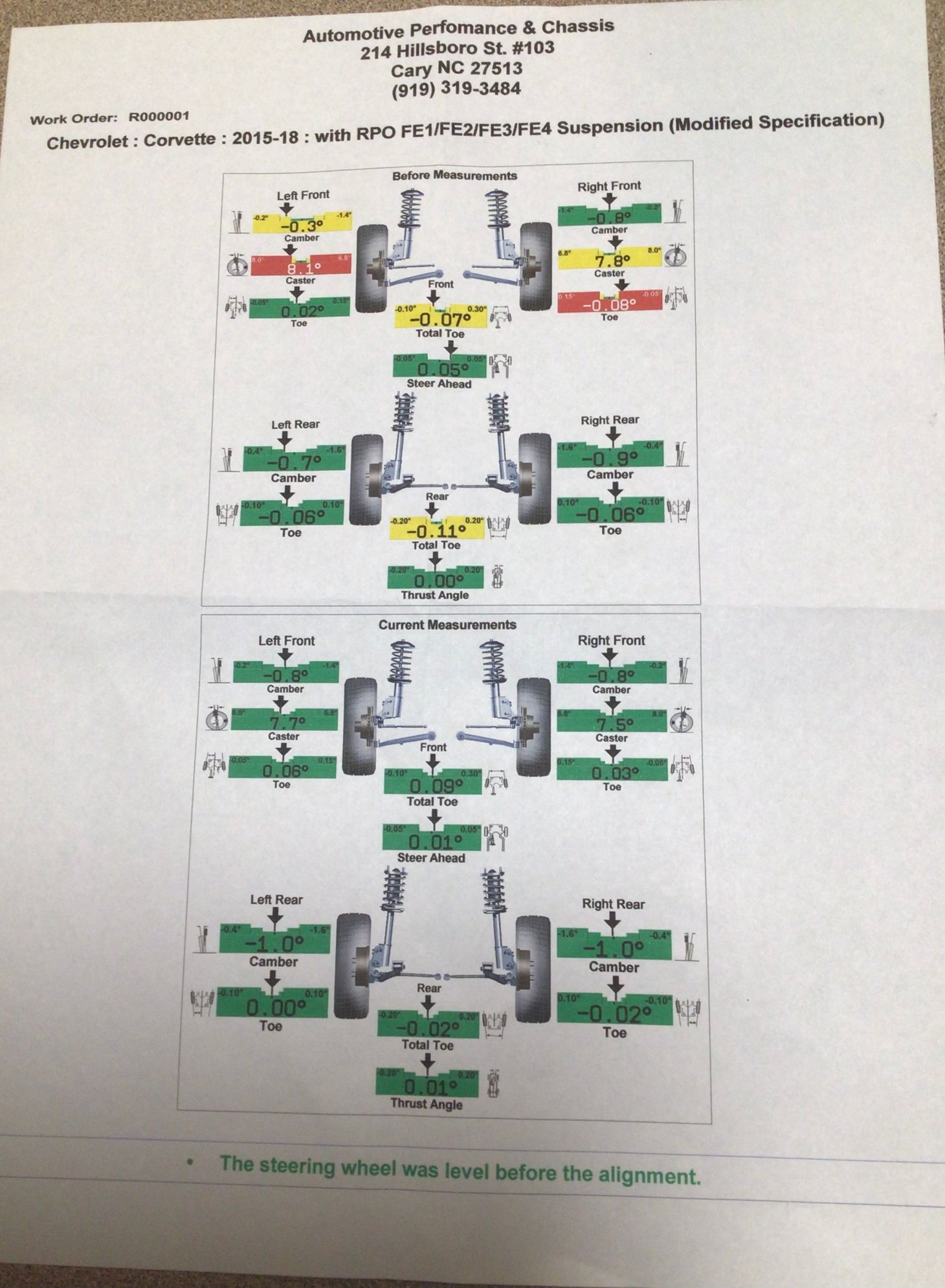

For what it’s worth, I had noticed excessive inner front tire wear so I took it to a local shop to get it checked and aligned. The car had 13K miles but the front inner most tread blocks were worn almost through the tread. Glad I caught in time. I hope this solves my tread wear issues. I requested to get longer tread life and this is what he set for. From my quick research when I was looking to see who should do it revealed the guys at Performance Chassis are the ones to take it to for my area. It looks like they used less camber than what Ammo's spec sheet shows. I’m no alignment authority but, seems strange that sheet shows the toe measurements in mm vs deg. Is that a typo? Wish I knew how to compare the toe #’s
