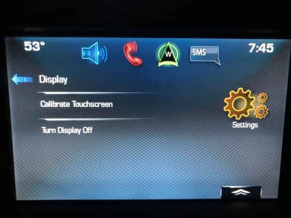

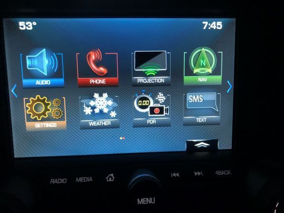

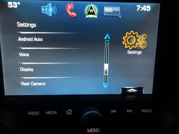

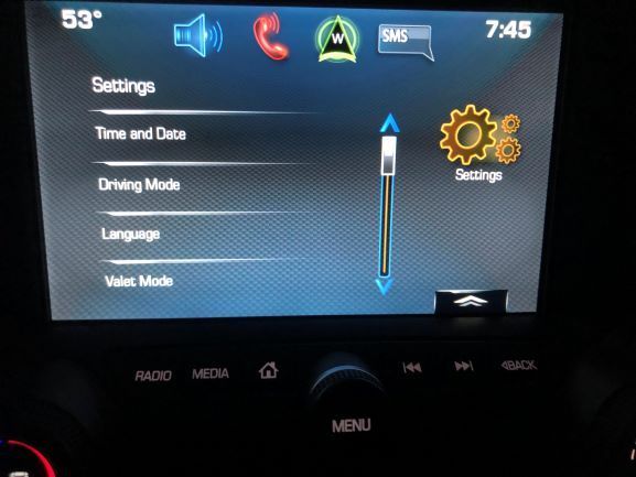

From the Home screen, go to Settings.
On the Settings screen, you may need to scroll down to see the selection for Display.
Select Display and you see an option to Calibrate Touchscreen.

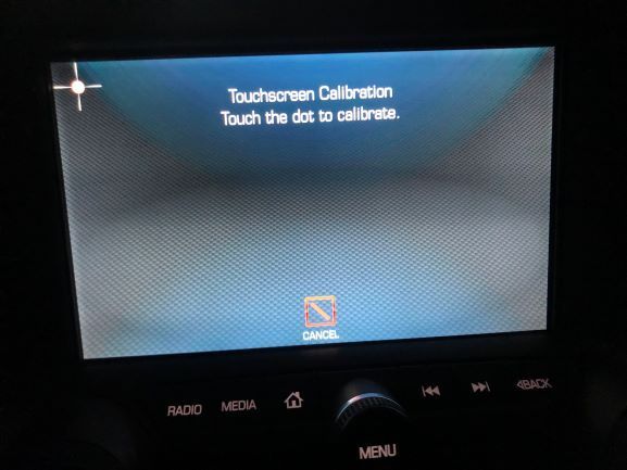

Select Calibrate Touchscreen and the calibration screen appears:
--KLG--
Then the calibration screen appears:
--KLG--
I didn't know there was a calibration for that. Thanks for sharing. I guess I just never looked for it because mine has worked fine from day one.

That calibration just centers it, nice to know where that is though, thanks. I just went out and tried it, its not too bad but its 40F outside, not sure if temp matters. The other day it was 75F and I had a hard time with it.
