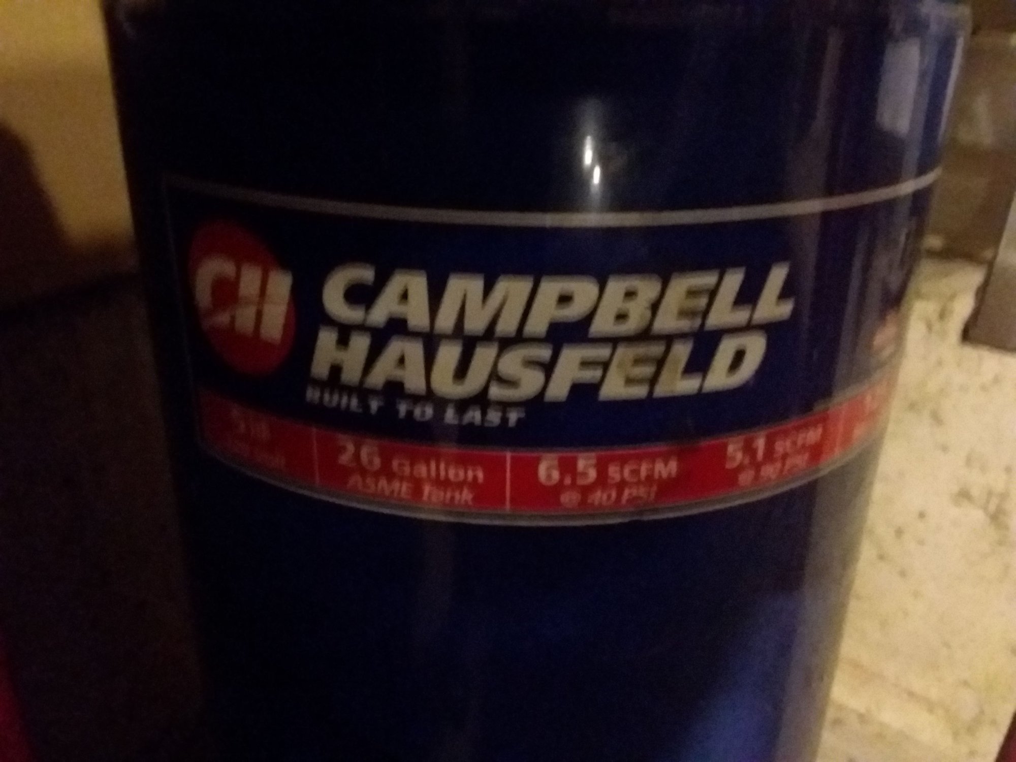

Hey buddy I bought this one 15 years ago and its worked flawless. However it doesnt work very well with sanders. You need more power for that.

I attached a pic. Not sure why you cant see it. Its a Campell Hausfeld. 26 Gal. 6.5Cfm@40 psi and 5.1@90. 5hp.
