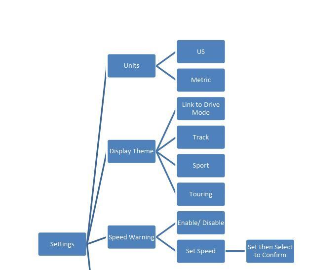

Here is a very good video of what you want to do. I don't know if you have viewed this one, but it is very specific for you. Start at about the 2 minute 30 second part.
Also here is a schismatic hierarchy that may be visually more suitable for you.

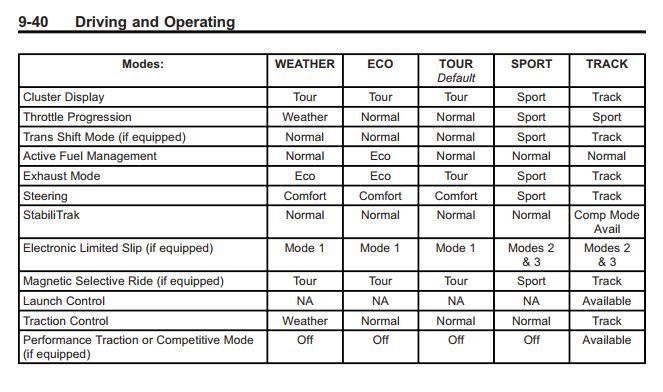

Another Question with the Stingray 1lt has all setting for ECON,TOUR ,SPORT,TRACK does the ride change With out the MS option
If it doesn't than why have the option to switch them
To Linking to mode displays
Old Feb 10, 2021 | 08:03 AM
joemessman's Avatar
joemessman
Joined: Nov 2015
Posts: 7,382
Likes: 3,501
It will change other characteristics of how the car behaves. Not just how the suspension. See the chart.

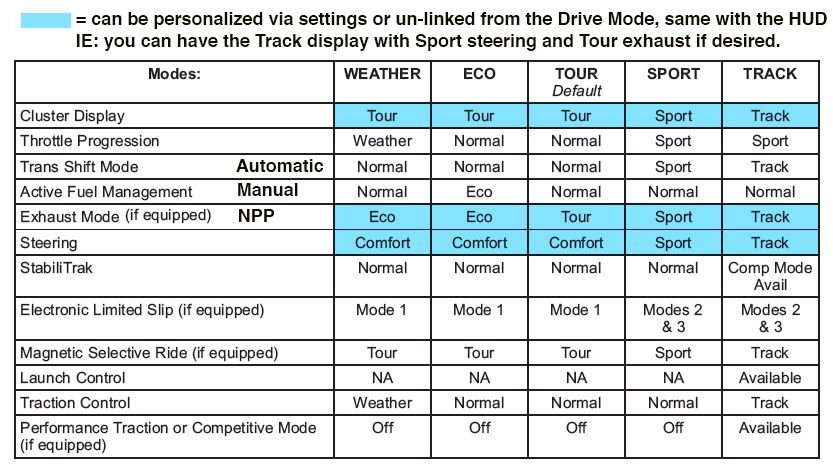

Here is a new chart I created that might explain things better... the areas in light blue can be set independently.
I also fixed the (if equipped) for the NPP exhaust, GM missed that one plus clarified the auto vs manual transmission areas.

Thanks good chart
