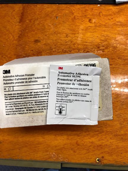

Use an adhesive promoter too for the most secure bond.

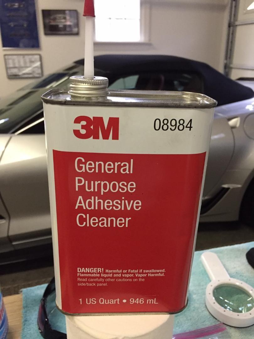

I'd use 3M 08984 General Purpose Adhesive Remover for cleanup from old emblems and as others recommend 3M double sided emblem tape. The 08984 is great stuff, no garage should be without a can.

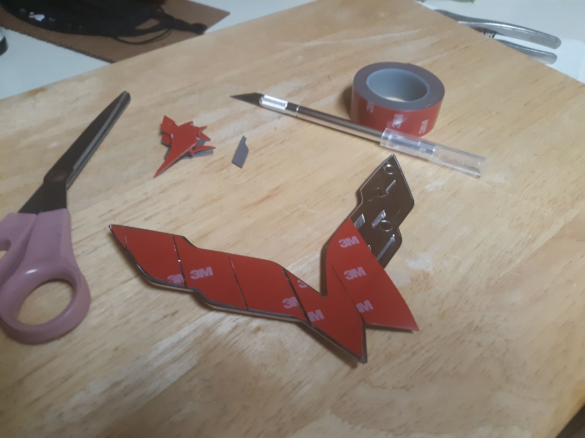

Well it was a dreary day today, so I got out my x-acto knife and put some 3M tape on my front emblem. Turned out better than I thought. Will wait for warmer weather to take off rear emblem and install stripes.

NICE JOB on that tape application

Don't forget the adhesion promoter.......
