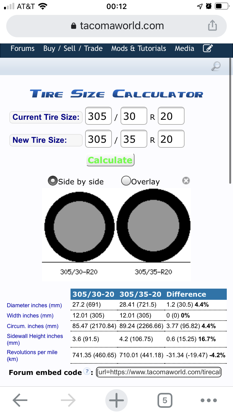

Looking for some first hand experience. I have a 16 Z51 with OEM wheels (245/35 19 and 286/30 20).
I’m wanting to get a set of Toyo R888Rs but there are some size limitations. I’d like to increase from the 285 rear a bit and I’d scale the front along with it.
Issue is the r888r some in 285/30 (cool, OEM size) or 305/35. This will increase my diameter a little over an inch. From what I understand that would be within the threshold for the nannies to not freak out but was hoping someone had some experience they could share.
Id move the fronts to 265s.
thanks
Size comparison for reference
R888r sizes
