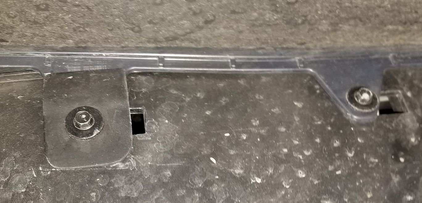

Shortly after taking delivery of my GS in 2017 I noticed my right tab had broken. The break was about halfway into the tab which provided some surface to mount a piece of reinforcing aluminum. You can see from the photo how it fits and it has held up for almost four years. Being OCD I painted it black so it wouldn't be noticeable, as if anyone would notice it in that location anyway. I might've sandwiched a dab of epoxy on the surfaces but if so I see no remnants of it anywhere. If the break is further into the broad end of the tab (toward the air dam itself) you might need to go to Plan B, as there might not be enough surface to butt the repair piece to. Post a photo and we'll take a look.
Regardless, there should be a way to fix it even if you must fabricate a 90° piece of metal and bolt it to the air dam. Seeing where the break is located will help, but I don't think glue alone will be a good long-term fix, as one bump would likely break it.

Thanks for the reply. My problem is the break is in the radius just as the tab does a 90 degree turn and becomes the deflector. I was thinking plastic weld with reinforcement.
I didn't notice that the break was at the 90° turn. If there's some solid surface on the air dam end I think probably a similar cut of aluminum at a 90° angle and fixed with epoxy (e.g., JB Weld) might work. I would also add a couple of small bolts with washers on the air dam end. I've never used "plastic welding," so if you go that route please send us a report.

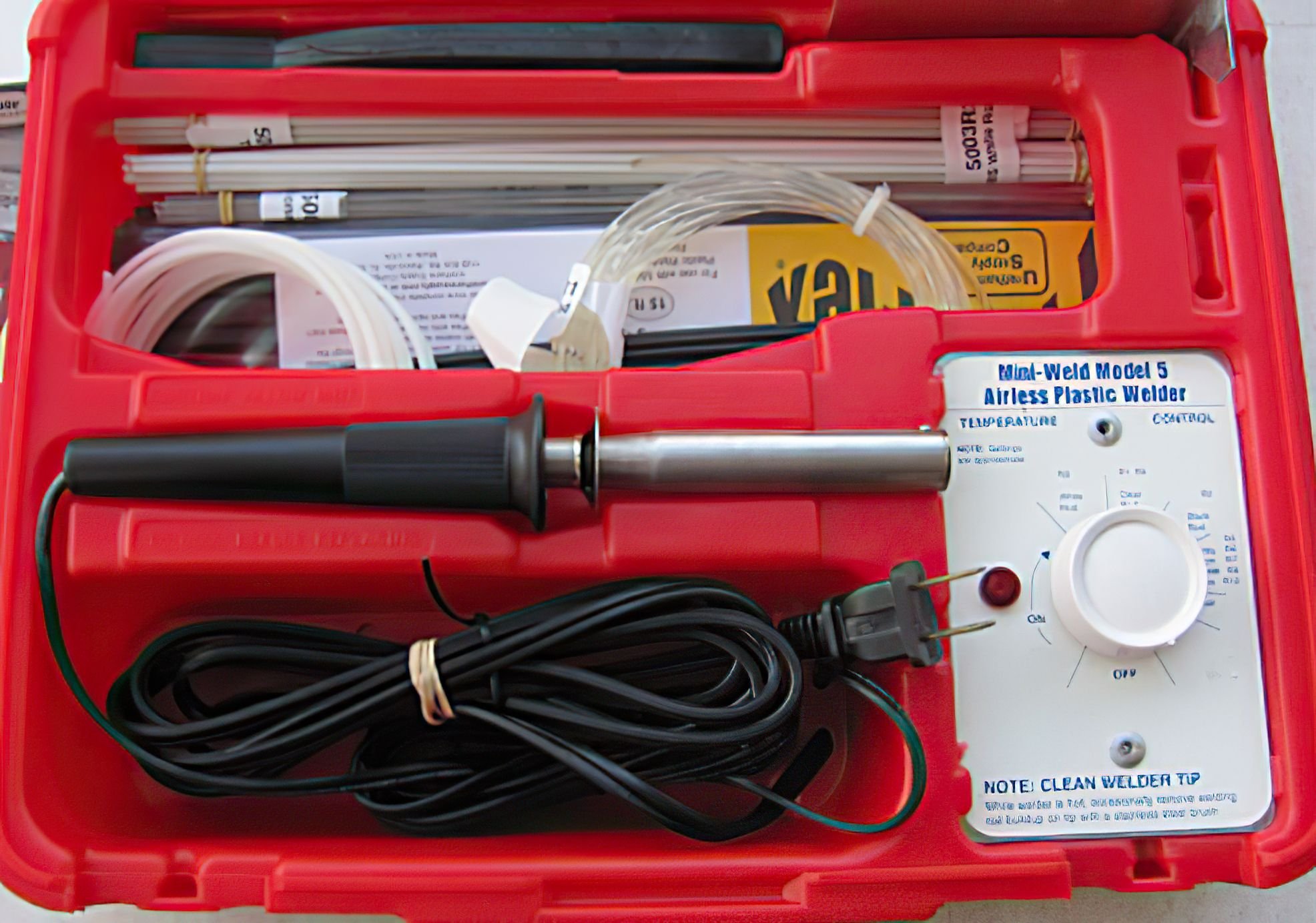

I have used a Urethane Supply Co Mini Weld Model 5 Airless Plastic Welder 5500HT for many years, I have found some things easy and some difficult. You need to match the rods well with right material.
