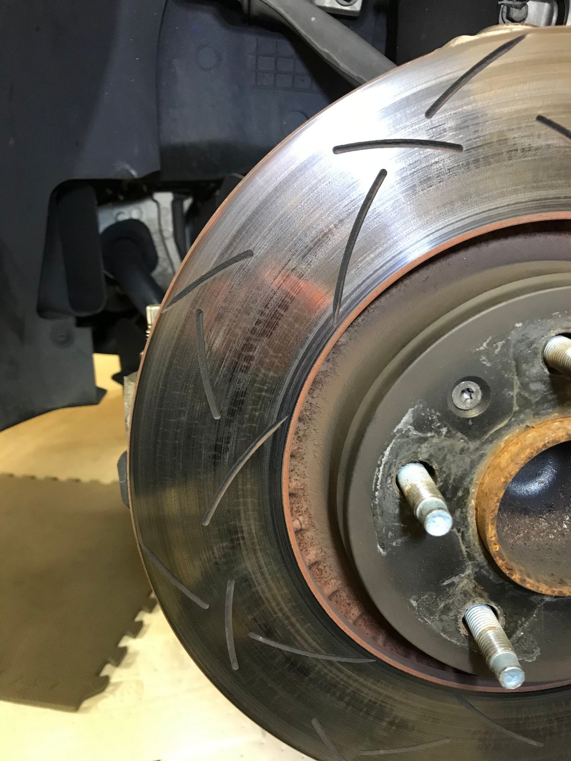

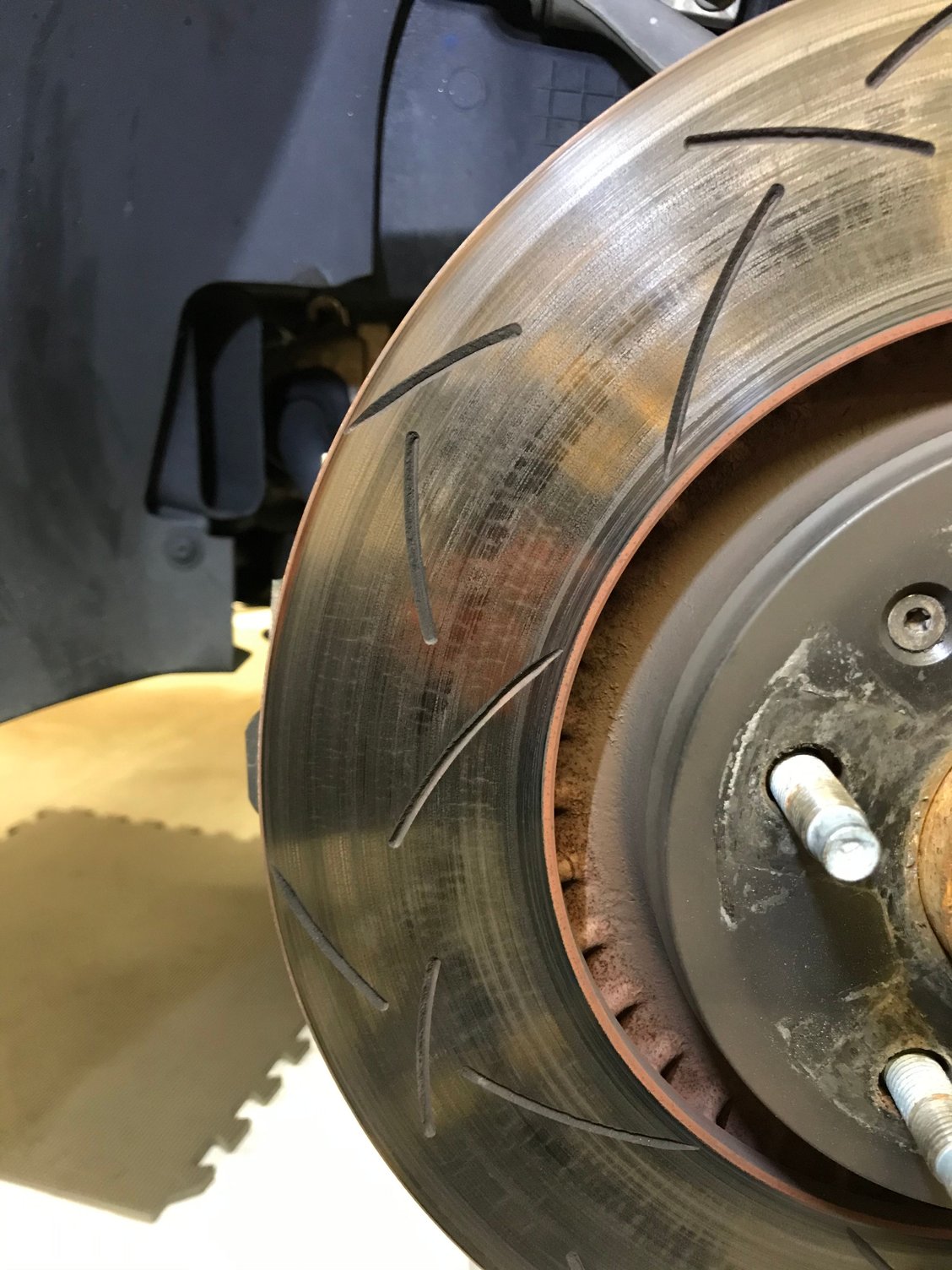

These are DBA rotors. T3 4000s.
They’ve seen 6 track days so far. I noticed these minor surface cracks on all 4 after my last event 12/6/2020
Last year was my first year tracking. So, I not sure if this is normal or what it means. I meant to ask this a while back but forgot.
Thanks for your input.

I think that’s a C7 Z51 front?
That looks pretty good. The pads are smearing a bit but front wear on those brakes is high because the brakes are only moderately sized for the car. They have life left. If the car stops we’ll just keep an eye on it and have spares ready

I think that is pretty normal for tracked rotors. I've been advised to watch the cracks and if get towards the outer edge, time to replace. Mine look similar to yours right now.

Mine look about the same maybe a little worse after 5 track days.
