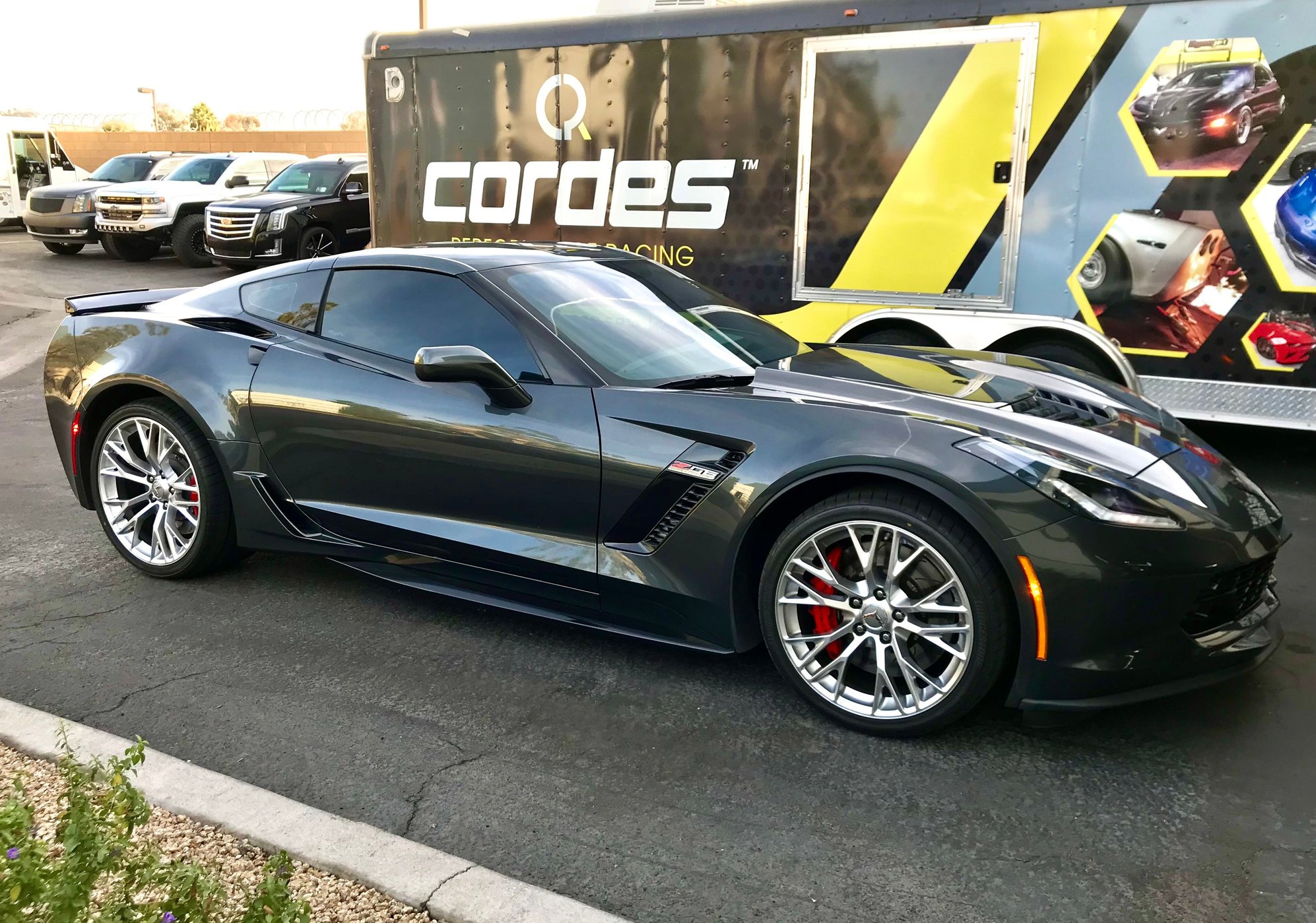

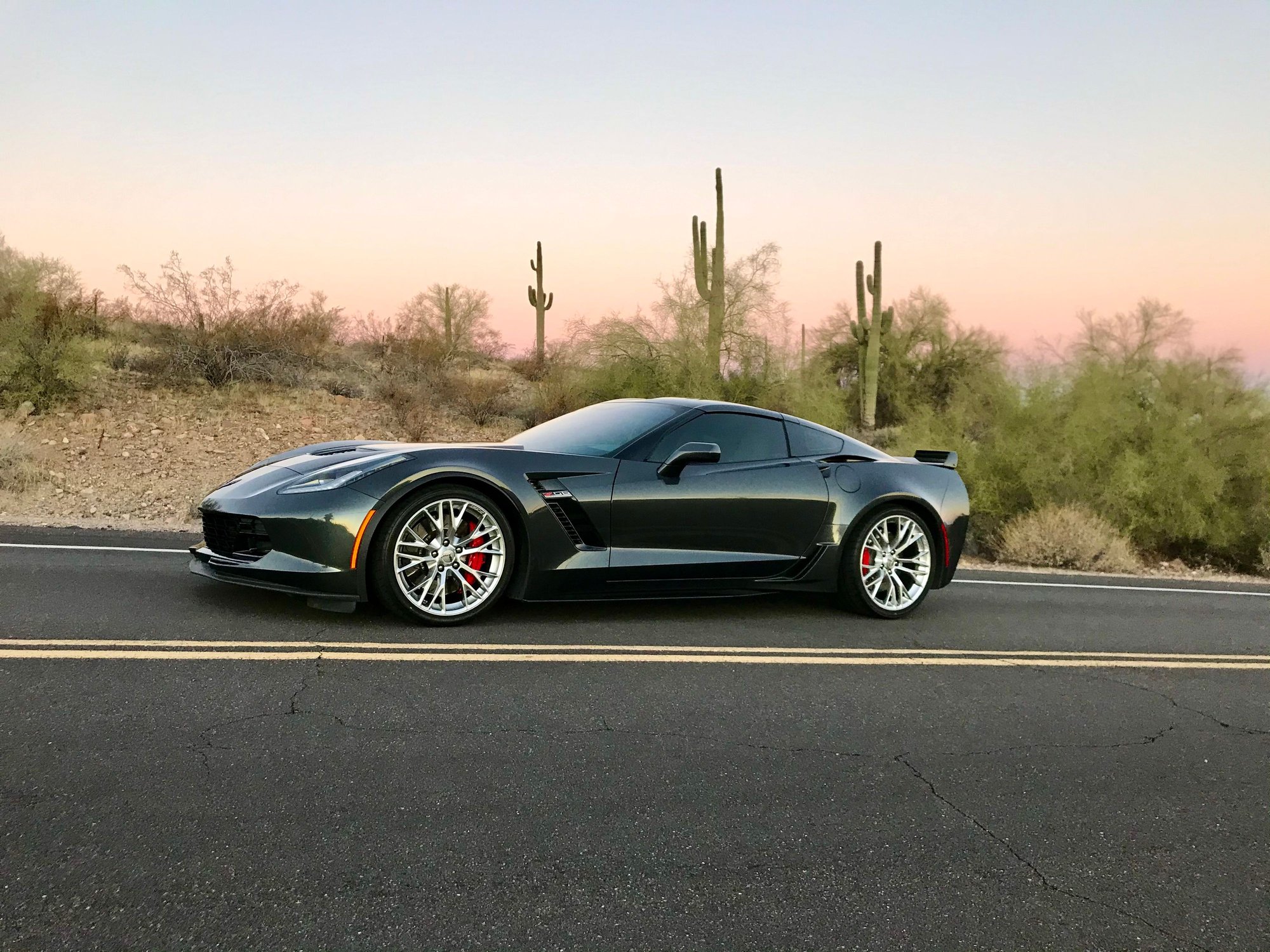

Mine was lowered all the way on stock bolts. I just did it to get rid of that gap between the wheel and the fender which did not look right to me. Doing it with the stock bolts it only brings it down about a quarter inch, so there really are no issues. I had an alignment done shortly afterwards, but I’m not sure if it was truly necessary.
Before - just as she was heading in to be lowered
A few weeks later, after she had time to settle
