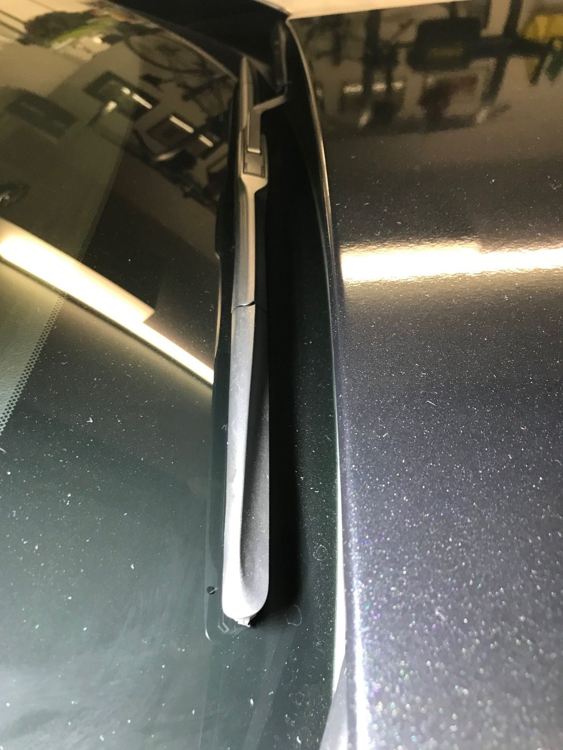

Agree....BUT, my problem is my Dealer's inability to ADJUST the wiper arms so that they DO NOT whack onto my A-Pillar. Pity.

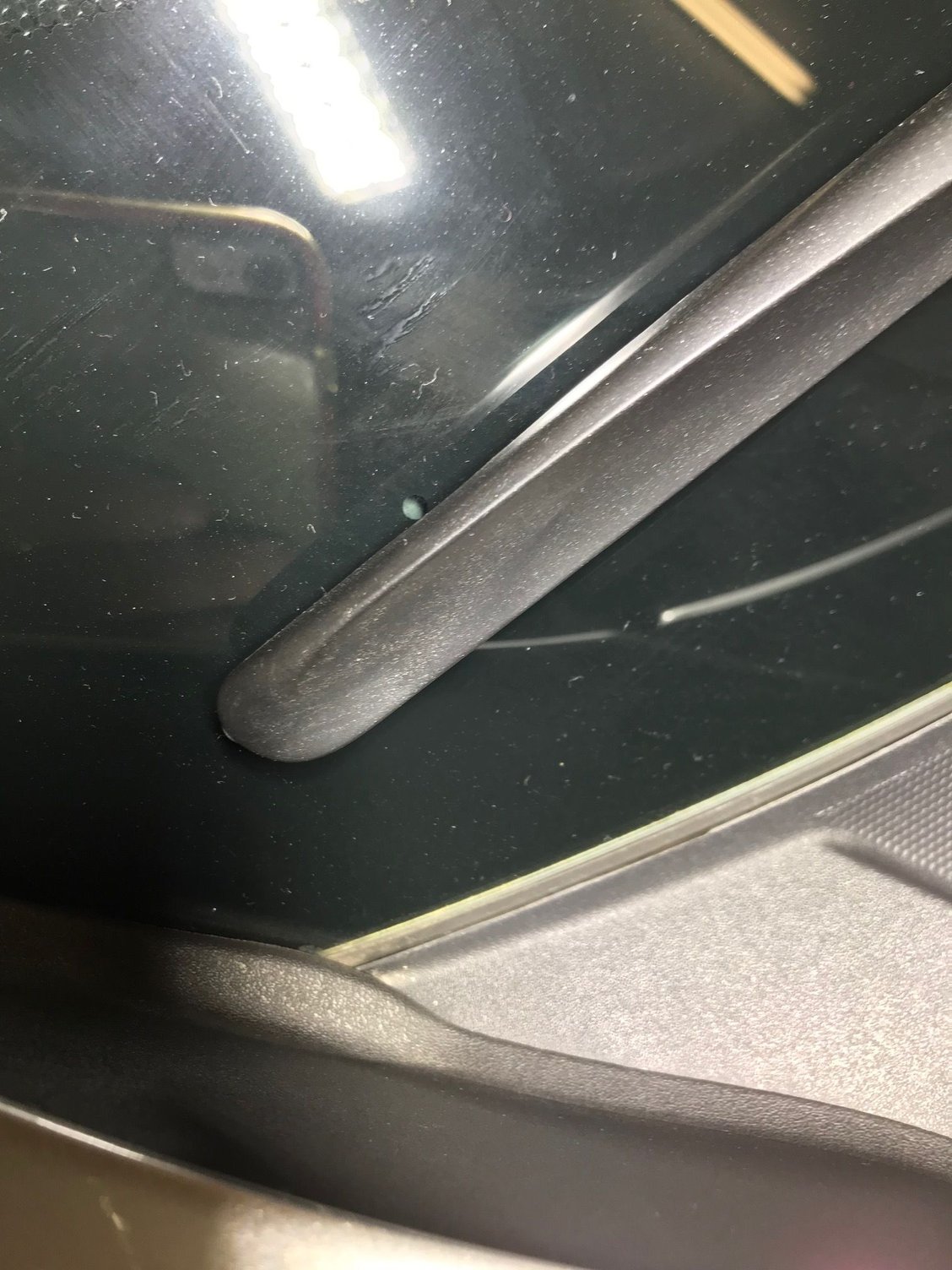

They shouldn't be difficult to adjust so they don't hit your A-Pillar. If you loosen your wiper arms from the pivots and adjust so that the blades rest at the windshield 'reference dots' depicted below your blade travel should be correct within your windshield on not hit the A-pillar.
