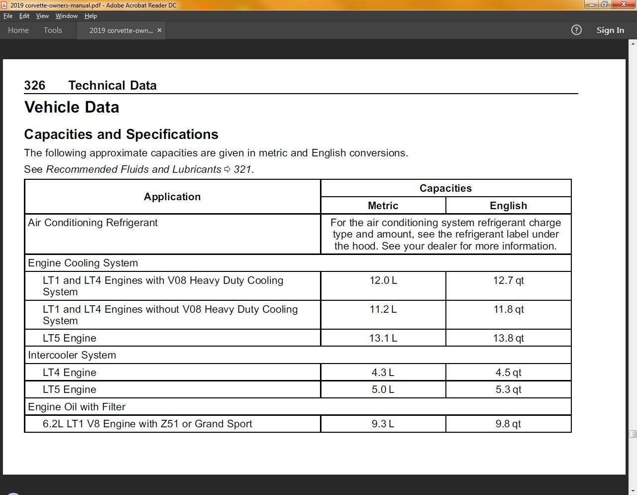

How can I tell if my '19 Z51 A8 has the heavy duty cooling option V08 ?
Your RPO codes I believe are in your rear hatch area under your carpet, near where the battery is. But if you have an A8, you get the transmission cooler mounted horizontally underneath your heat exchanger (V03, I believe,) not the auxiliary radiator that comes with the M7 and V08.

The RPO's on a 2018 and 2019 are encoded in the QR Sticker on the driver's door.
