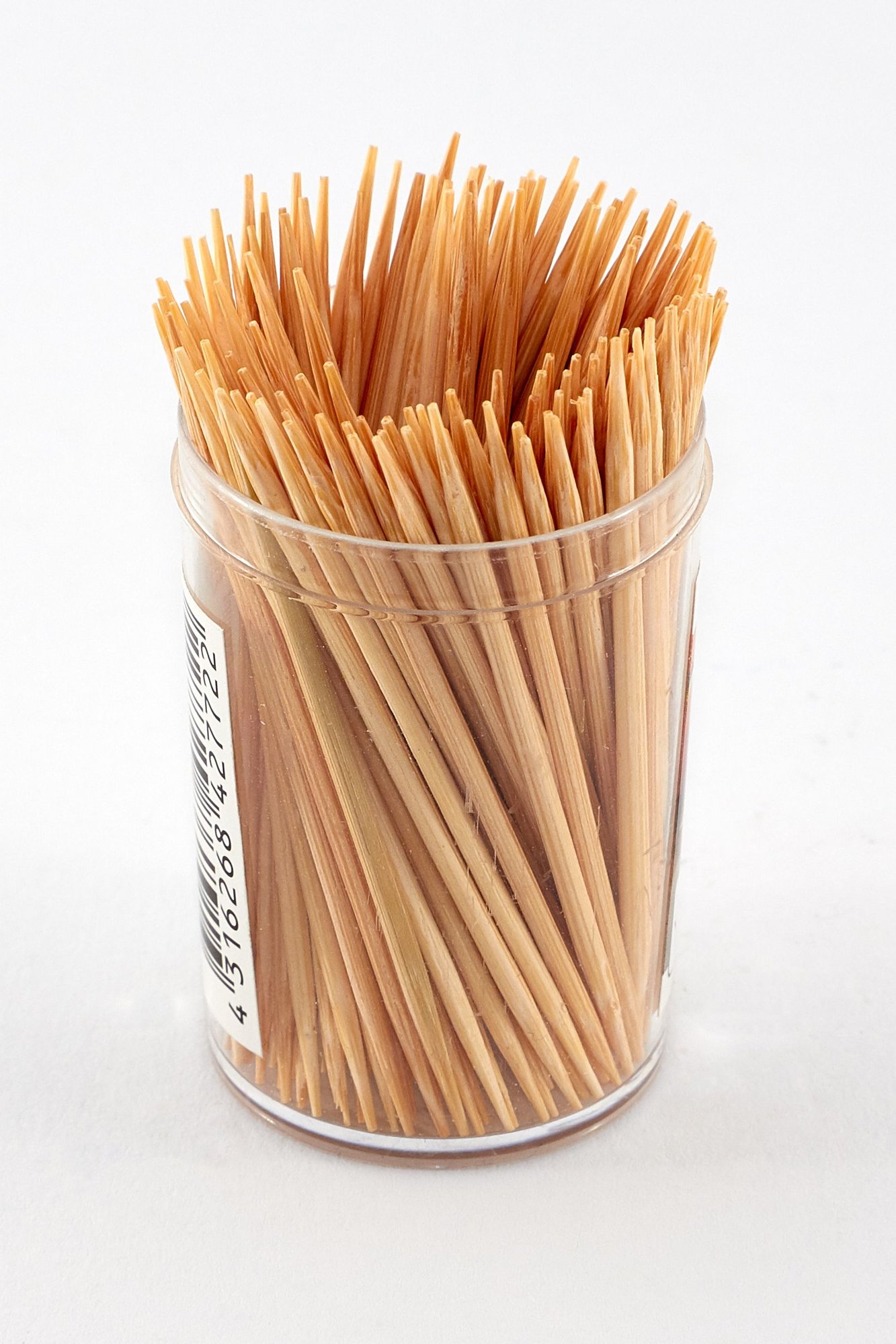

I use Artic White Touch up paint and the toothpick method where u fill the chip with paint using the end of a toothpick , much better that any brush
The good thing is , it's white , you will never see it from 5 foot away

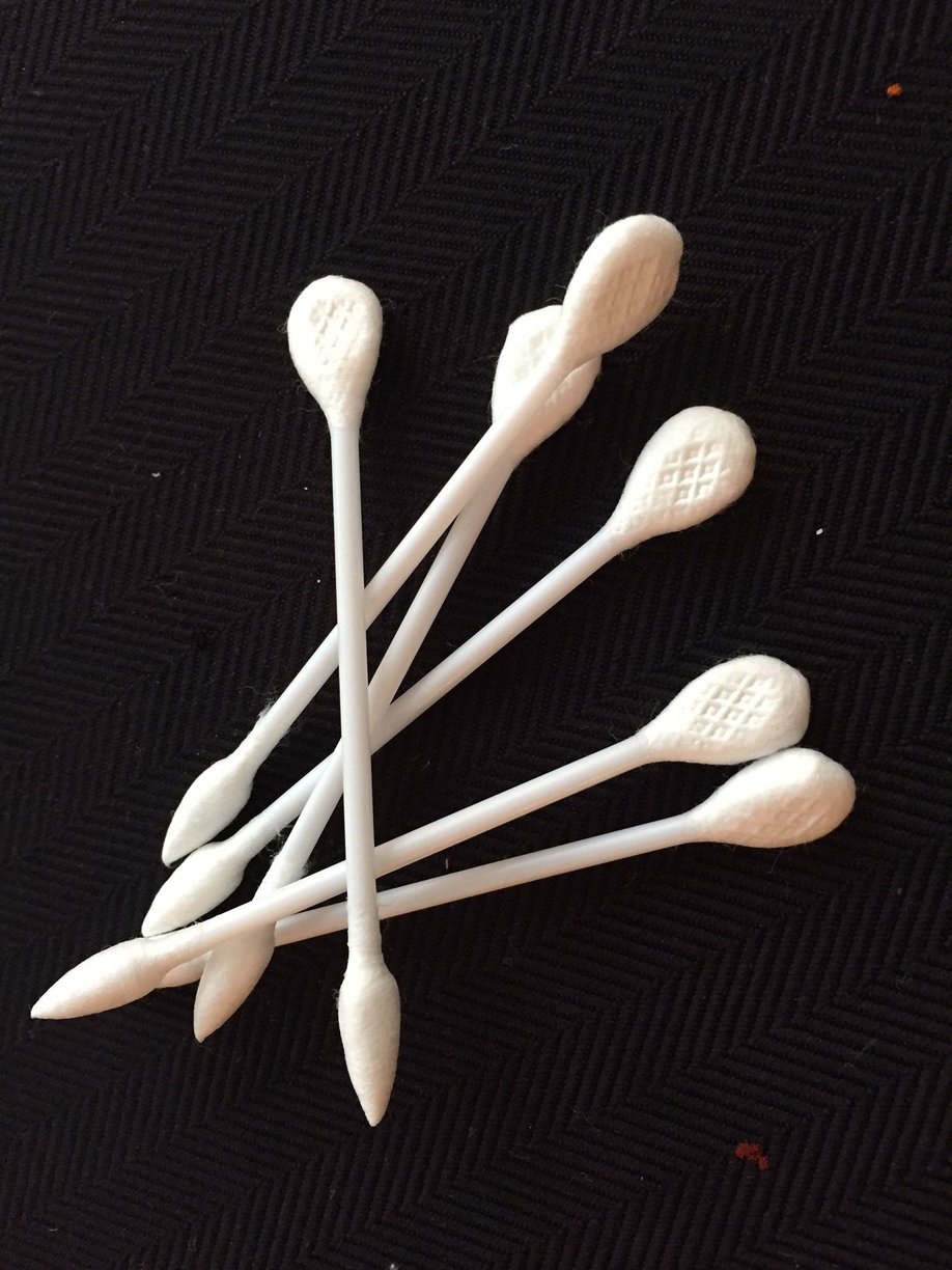

I have a spray can of Torch Red. I spray it into the cap and use a cotton swab
I use the below pointed cotton swabs for many detail tasks but doesn't the cotton (fuzz) get into the paint/repair?
Dave
https://www.amazon.com/ACDelco-19329.../dp/B010GGH550
I use toothpick method also and put enough paint on the end of the toothpick to fill the nick. Sometime have to do it a few times more after it dries . Lucky enough on my C7 Z06 it is entirely covered in Xpel so no touchup paint necessary !
Yes the cotton would get into the paint100% . Would use a toothpick instead 100%!

From: Waco TX
or a wooden match stick if chip is larger!
