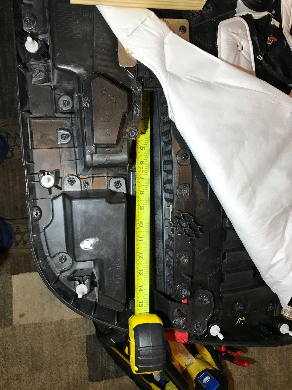

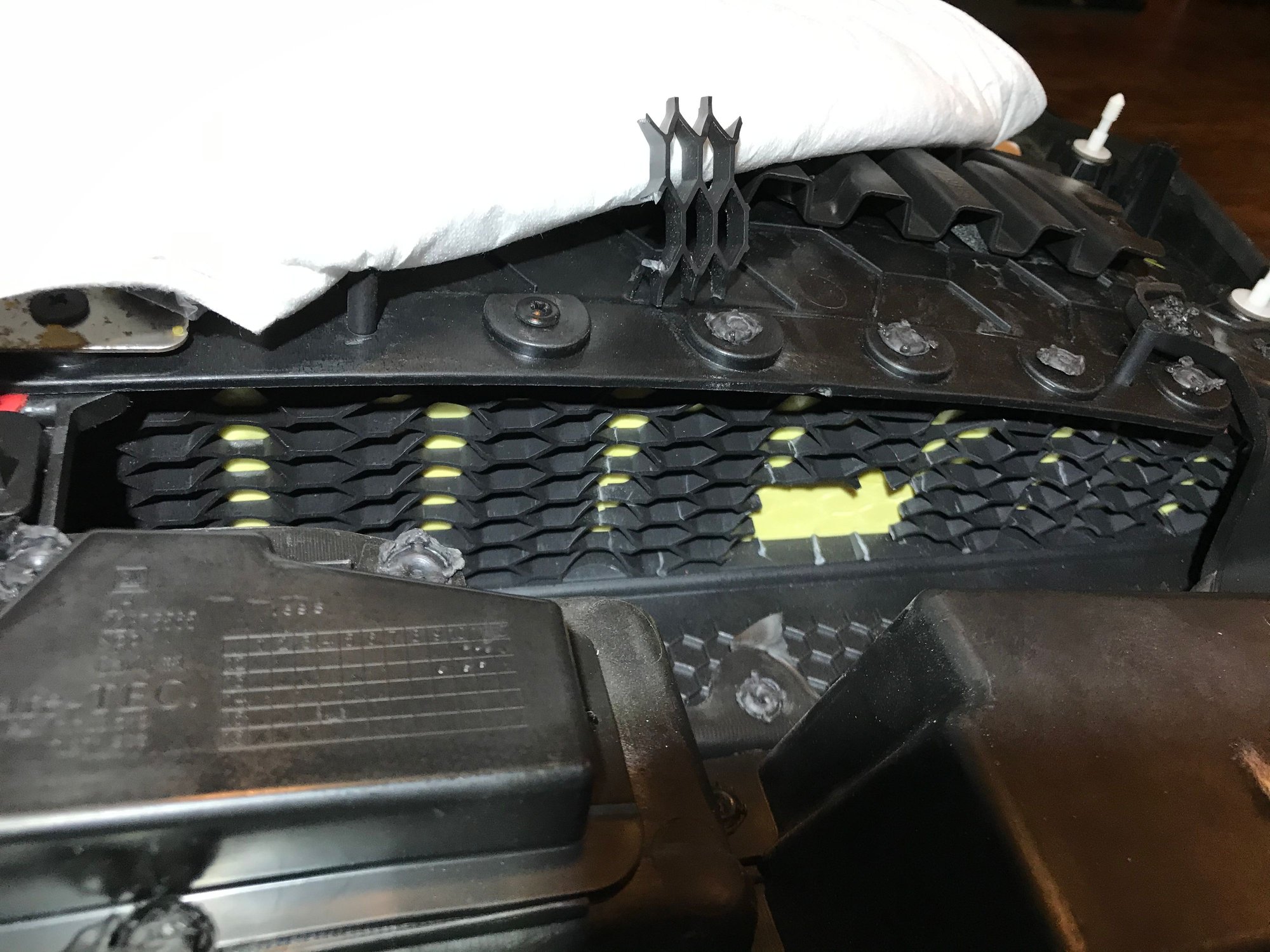

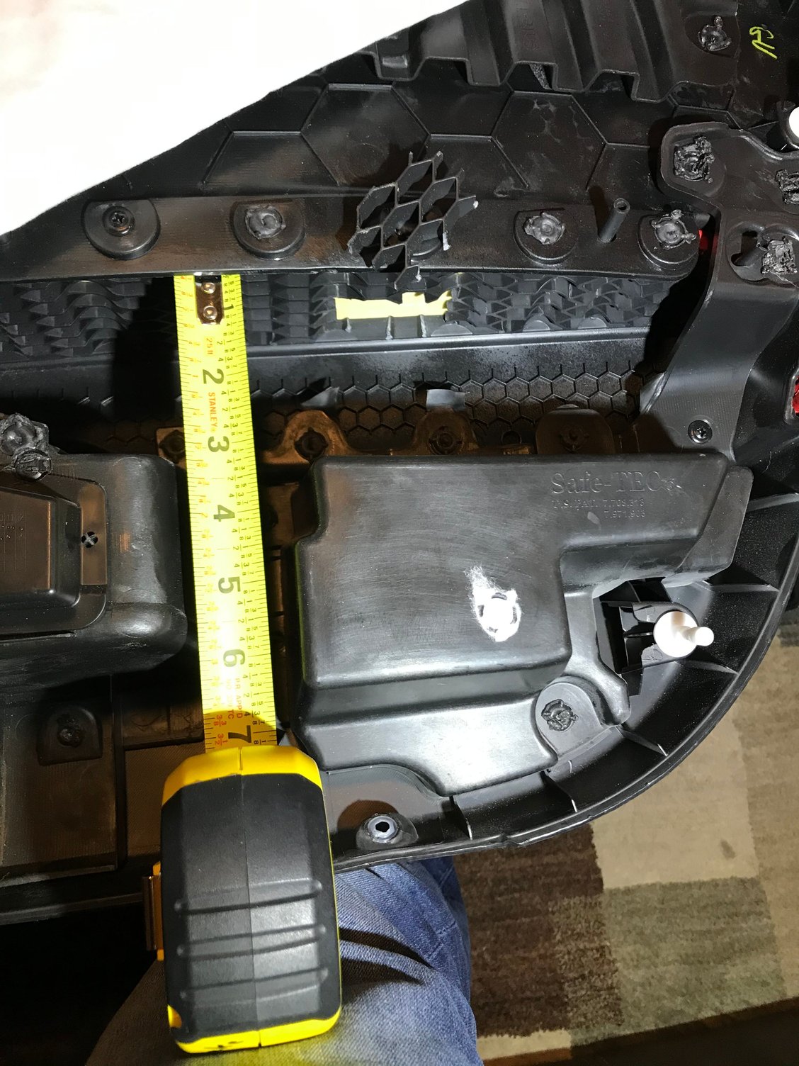

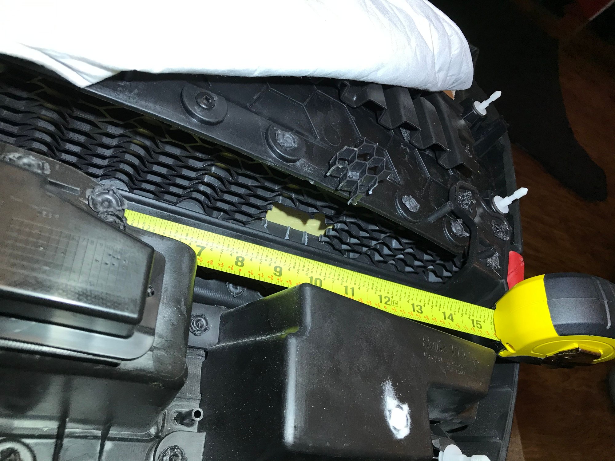

The internal framework of the armrest is...broken. Weakened. I could hear the crunching when leaning on it to adjust my seating position while driving.
I had the door panel off recently for an audio project and got a good look at the armrest architecture.
I have a few redneck ideas on how to “fix” it. But I’m certainly open to ideas.

JB Weld. Huh. I dunno, the bulk of that honeycomb structure has several cracks. I was planning on placing a brace of some sort...2x4, PVC pipe vertically or similar...put it under that area where the piece broke off and have the brace seated on that bulk piece below it. That bulk piece is hollow. Just something that would take some of the strain of the armrest if I lean on it hard. I've learned to avoid that sort of move now since I can really feel the armrest skin sink in when I do.

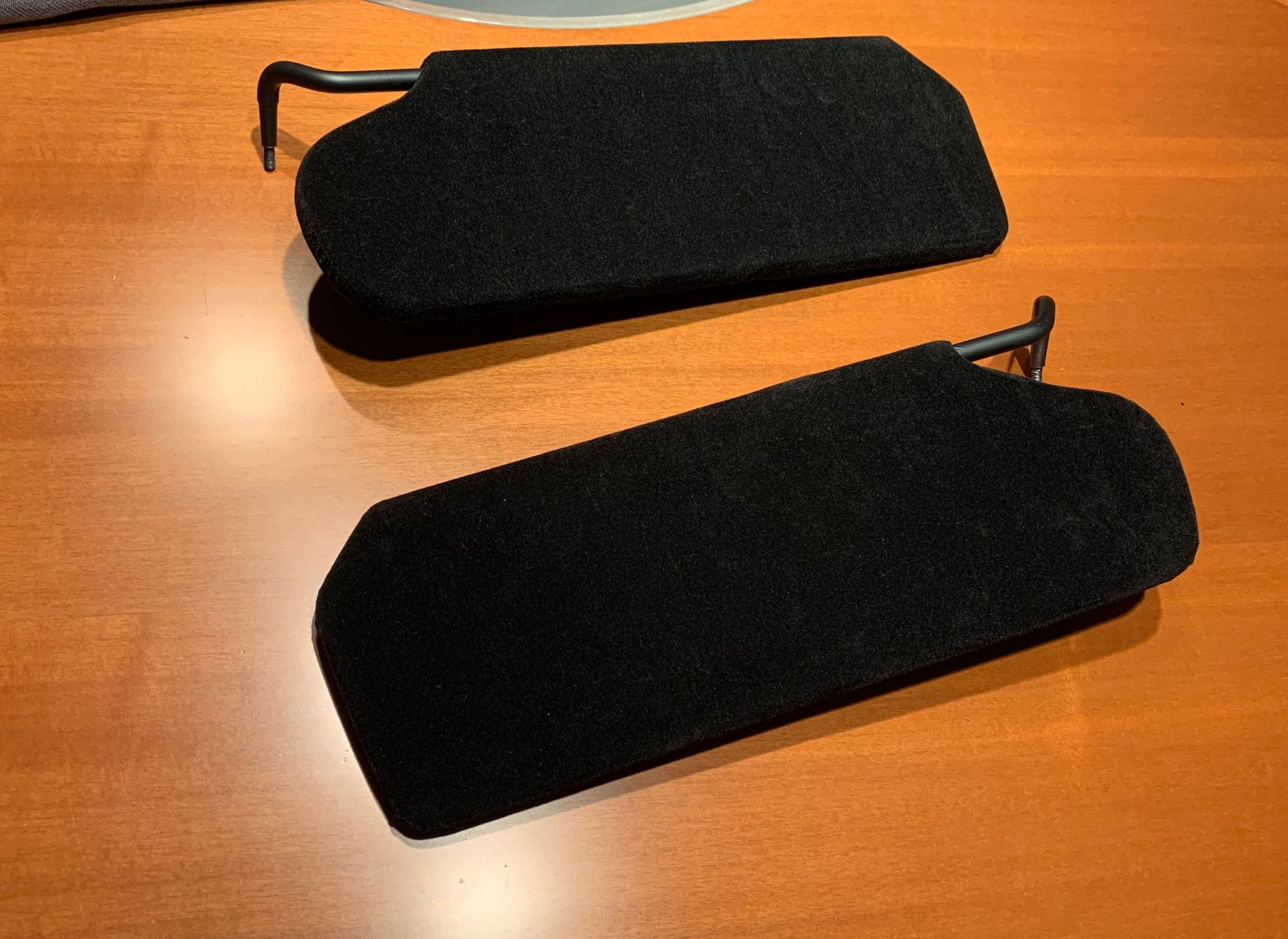

Well my friend, You’re going to bring out my inner redneck. Last spring I bought a 96 C4. The sun visors had fallen apart. So I got some 1/4” toe kick I had left over from my kitchen remodeling and made my own. Ordered some sticky cloth material off eBay to finish it off.

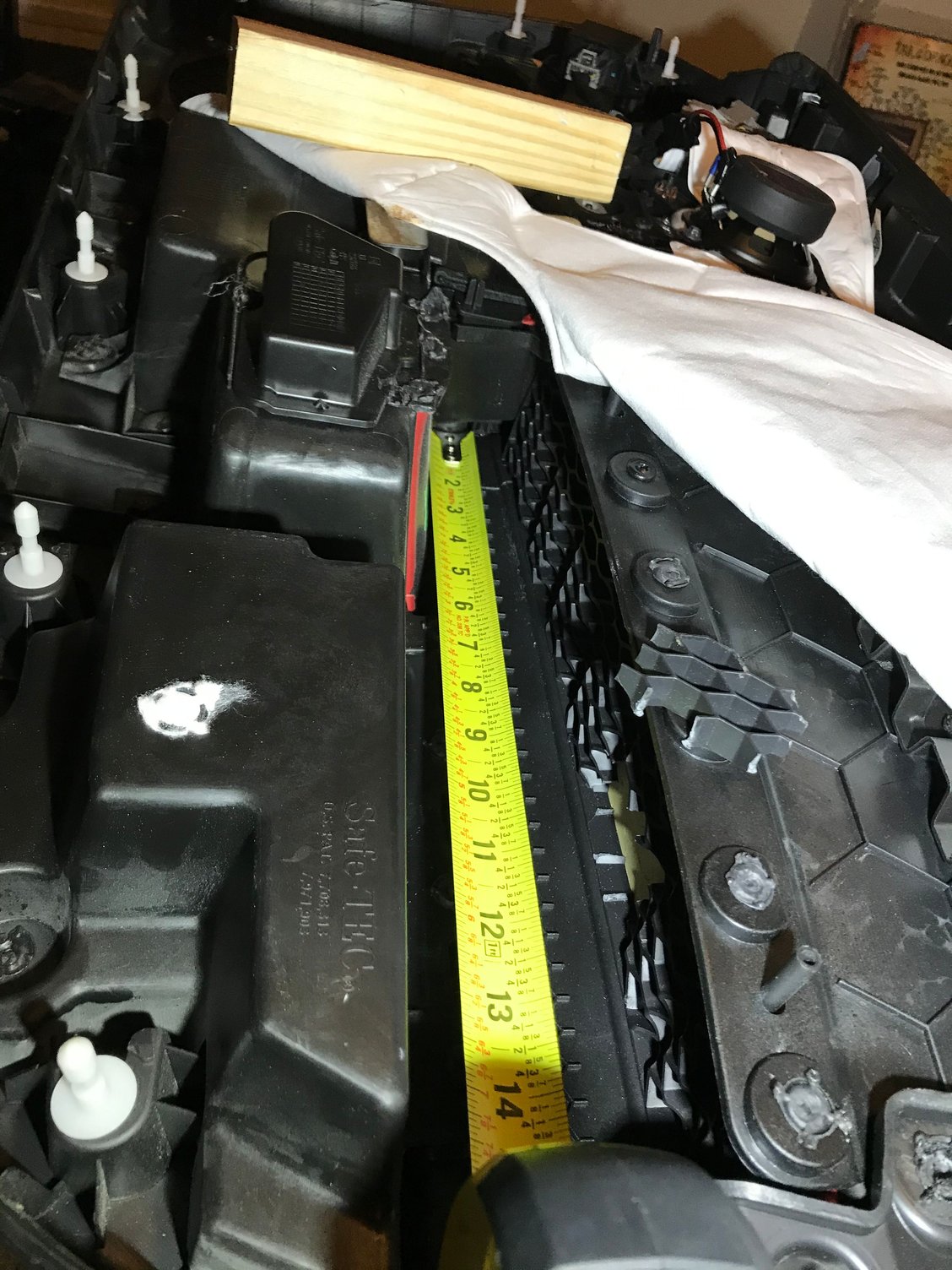

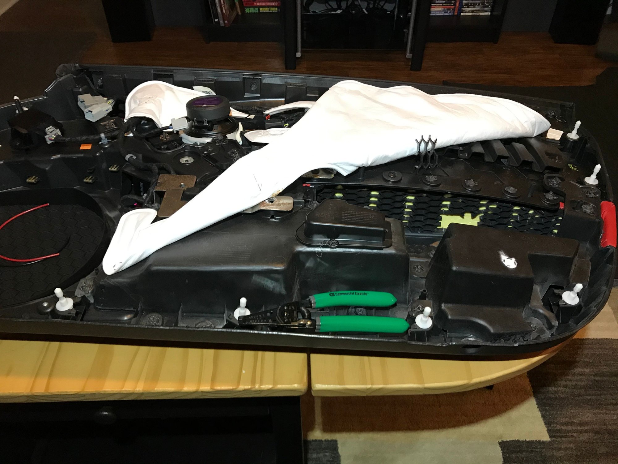

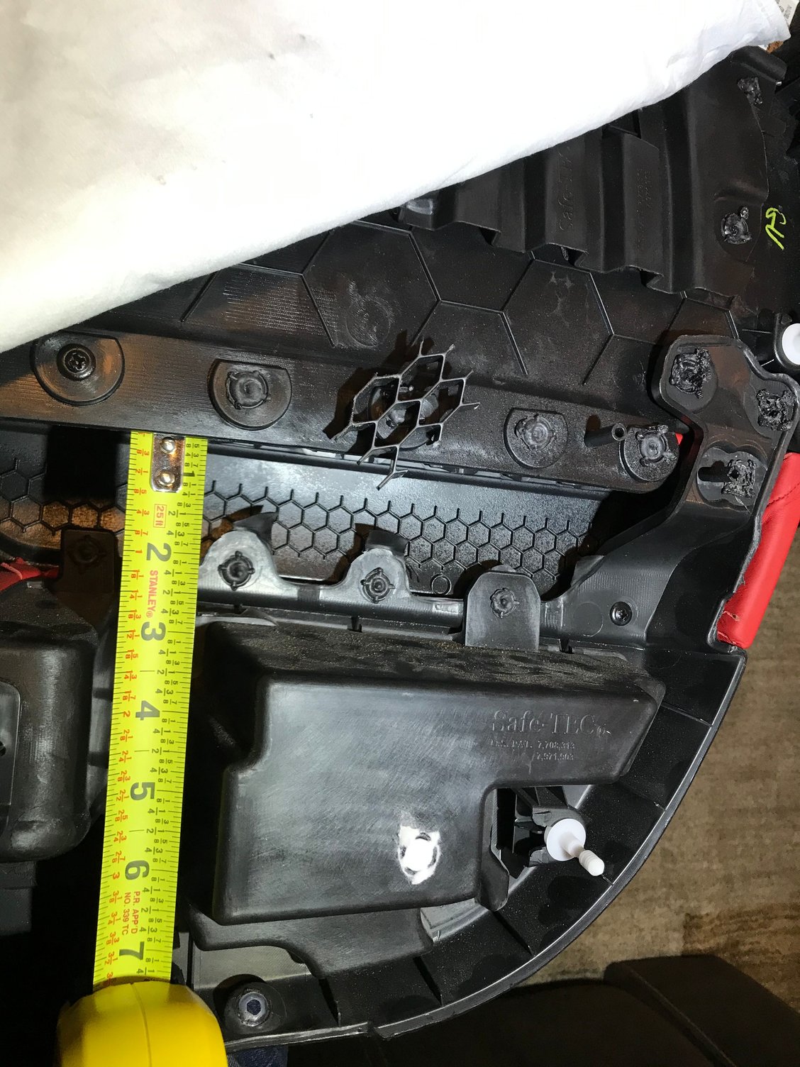

This is the driver door armrest. Panel was removed for a speaker upgrade project. My armrest had been 'failing' for over a year. Now I see why.

Your supposed to be resting on your arm...rest.
I guess your are..
If you have room for a strip of aluminum siliconed adhesive in for clearance?Strip stock is sold at Lowes or others.
I purchased a cheap grade front splitter and beefed it up underneath for strength and add some rigidity for good measure
Different thickness available.To check for clearance use a modelers clay or a play doe for squeeze.
Or simply put piece back in and load it up with the adhesive in between the honeycomb.
What the hell the frame is glued together.
I doesn't have to look good..Can ya tell

JB Weld is your friend. Perhaps the broken honeycomb piece can be glued with JB weld back in? https://www.jbweld.com/project-category/automotive
if the broken piece of plastic honeycomb lacks structural integrity - you can either build it up with "heaps" (technical term) of JB weld - or as you said - get creative with other materials... just make sure you spread the load transfer out so what you put in will spread the weight over a large area.

If you can get on to the top of the grid, the armrest cushion side, I would be inclined to cutting some thin wood that they sell at Home Repo. They sell some really thin stuff stuff there that is like 1/8" wood over by where they sell oak and the good wood. It is easy to cut, but you can make a cardboard template first then cut out. JB weld will stick to the wood really, really well.
Make a piece of wood for the top and bottom if you can, and sandwich the whole thing with good old JB weld in the middle. It will NEVER come apart of crack again if you can get to the top side.The key is to clamp it good overnight while it dries. Maybe you can get a couple c-clamps in there if the armrest itself comes off?
If the armrest itself is available, I would replace it now, but that is just me.
You can of course do similar with sheet metal, but I am not sure JB Weld would stick as good! Besides, then it would not be as Red Neck!
