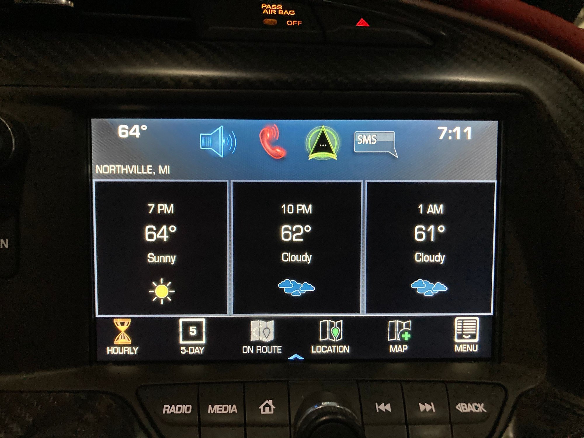

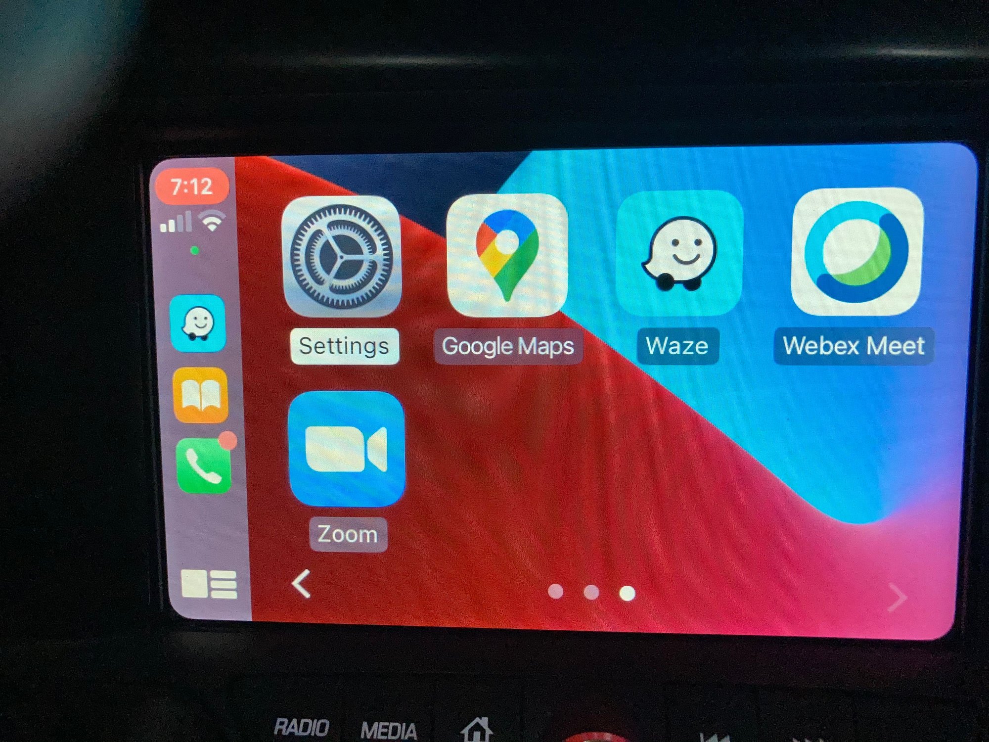

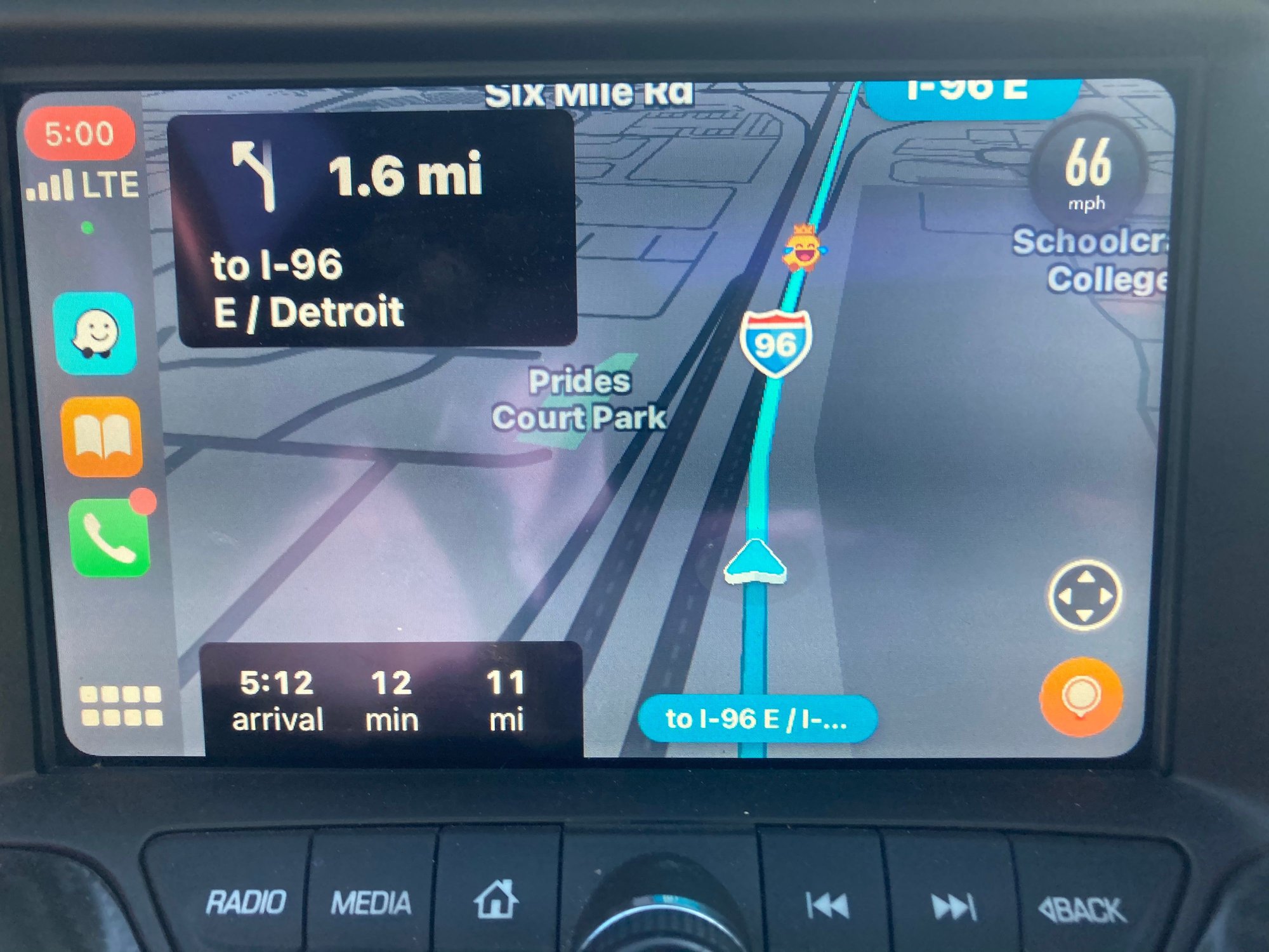

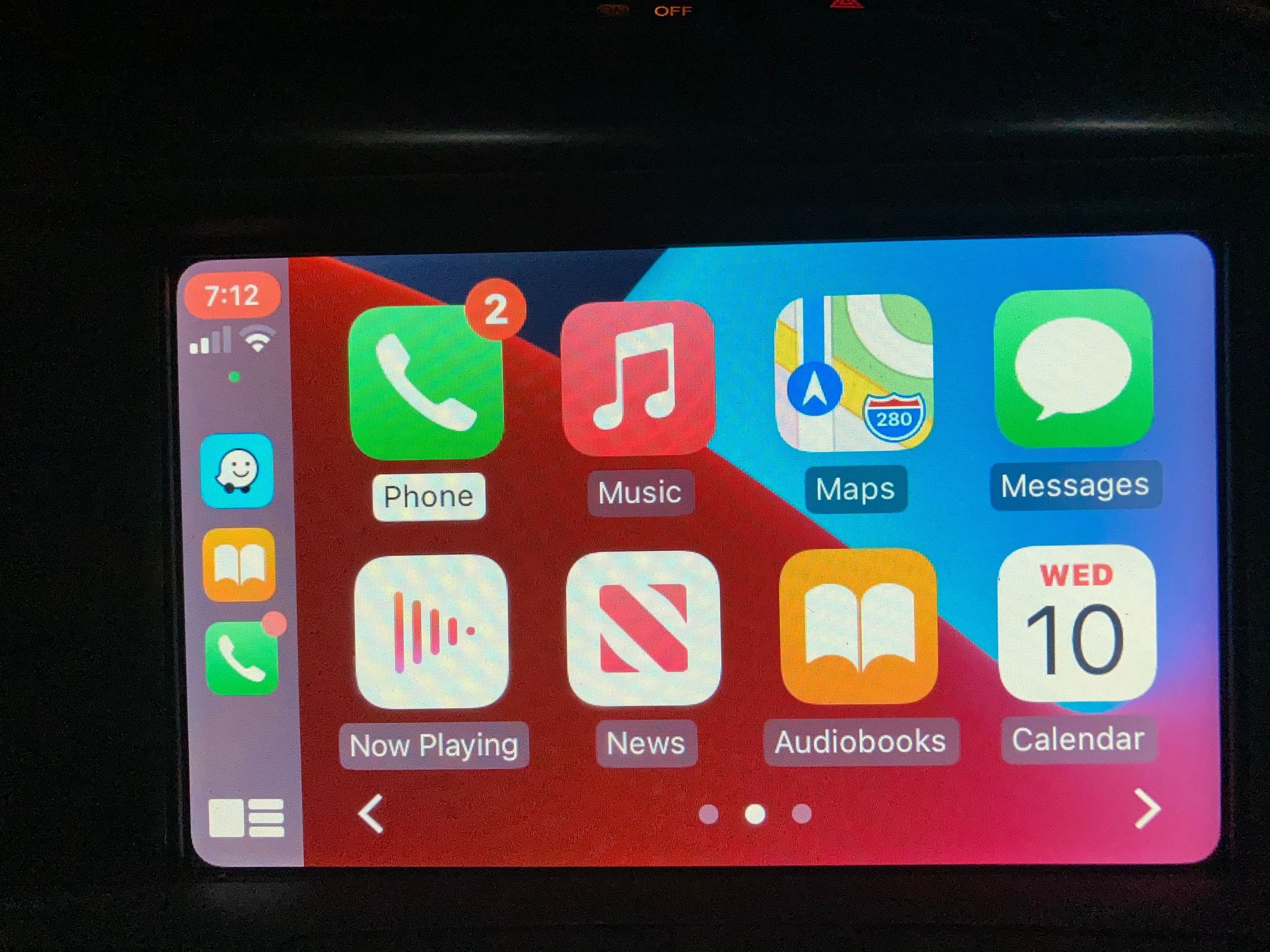

You can't deal with a stealership for something like that as they will have no part of doing it as you are really asking them do something to the electronics that didn't come that way and don't want the liability and could cause trouble with GM if they did. There are two companies that will program a HMI 2.5 for your specific vin number and then send you the HMI 2.5 to swap out your HMI 2.0. There are two options based on if you currently have navigation or not and it determines whether you get i0S-5 vs i0S-6
This is a post I did on the carplay......
I received my package today from MVI who sells reprogrammed HMI and Radio Modules and installed my new 2016 HMI and Radio Module on my 2014 C7 which gave me the updates maps and CarPlay. The responsiveness of the infotainment screens is so much better and being able to mirror my phone and do other things is just what I wanted. Here are some screenshots and information about the install. All 2014 – 2015 Models Please Note:
If you currently have Factory NAV; you will need to select the I06 option. When upgrading to the CarPlay/Android Auto System you are changing out your existing NAV module and adding the newer 2.5 navigation module with the CarPlay / Android Auto built in. Please contact MVI for assistance in selling your old I06 MyLink Navigation System.

These pictures are after installing the new 2016 reprogrammed HMI 2.5 on my 2014
