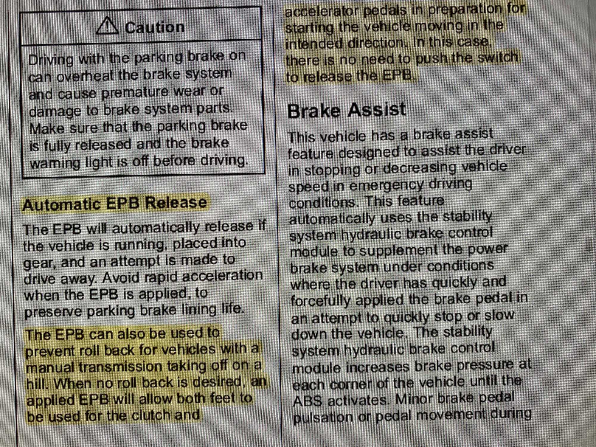

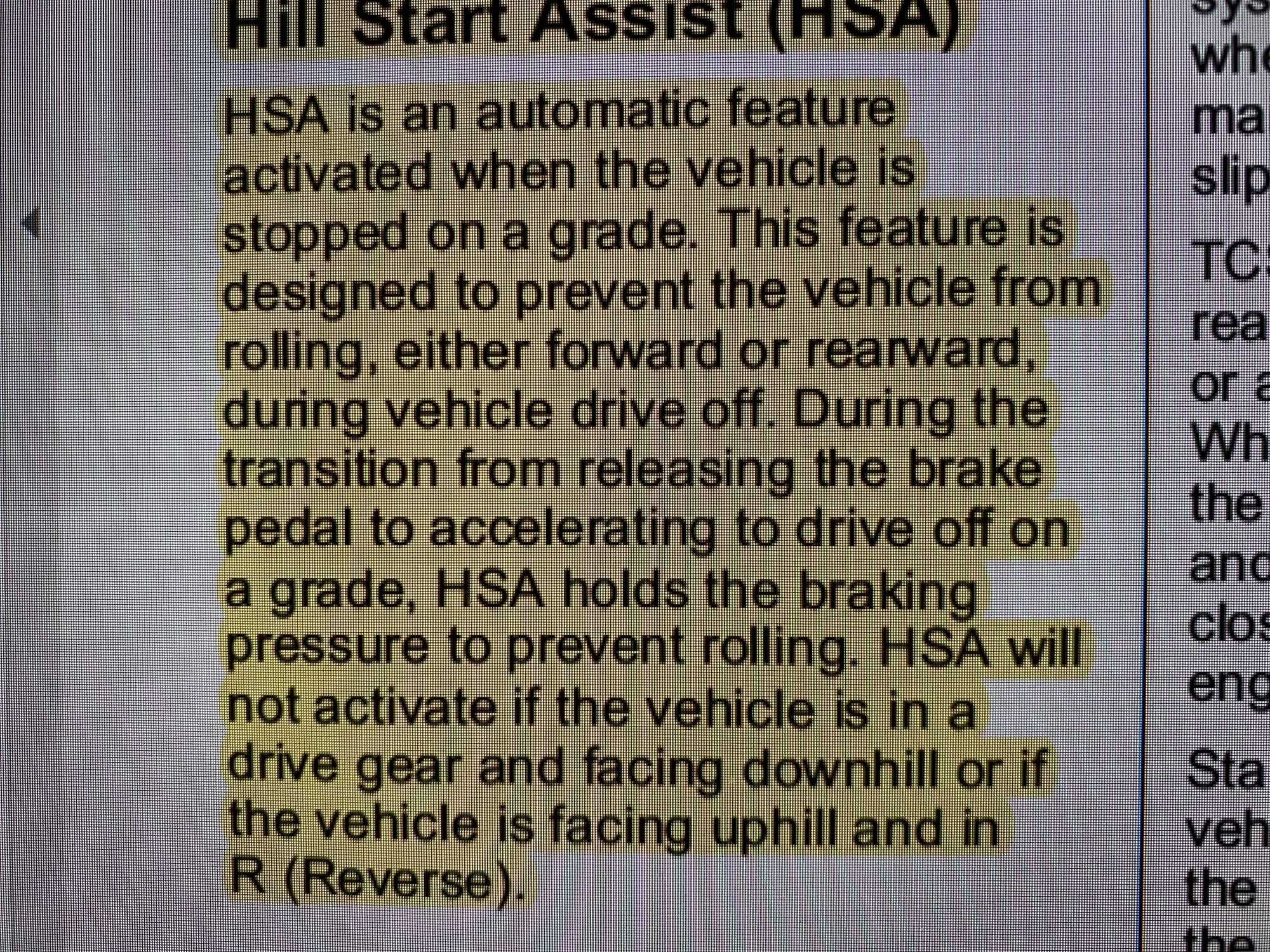

My personal experience with the HSA feature has been that it doesn't always work when you need it (i.e., the grade has to be fairly steep for it to kick in). Here's what the 2014 owners manual says:
I use the EPB for situations where some knucklehead pulls up so close and I'm on a grade where I might roll back just a little before clutch engagement. Here's the info on how that works.
In either case, I don't believe the brake lights go on. When activating the EPB in this case, the parking brake light illuminates in the DIC.

HSA and EPB are two separate systems. HSA uses the regular, hydraulic brakes while the EPB uses a power activated cable system. EPB is just the modern electronic version of the good ole hand-brake lever found in the center console of manual transmission cars. The lever has just been replaced by a electric motor that pulls on the cable for you.
As the manual says the HSA "holds" brake pressure. I assume this works by using the ABS pump to maintain pressure in the brake lines thus keeping the brake pads pressed onto the rotors so the car doesn't roll back. Now normally the brake lights are activated by a switch in the pedal, so when your foot comes off the pedal I guess it possible the light goes off yet the brakes remain "on" (held) for a second or two given you time to release the clutch. This seems like a bad idea as the driver behind will think you are moving when you are in fact sitting still. Not sure what the legal requirements are regarding this are, IE: since the brakes are "on" does the light have to be on too?
