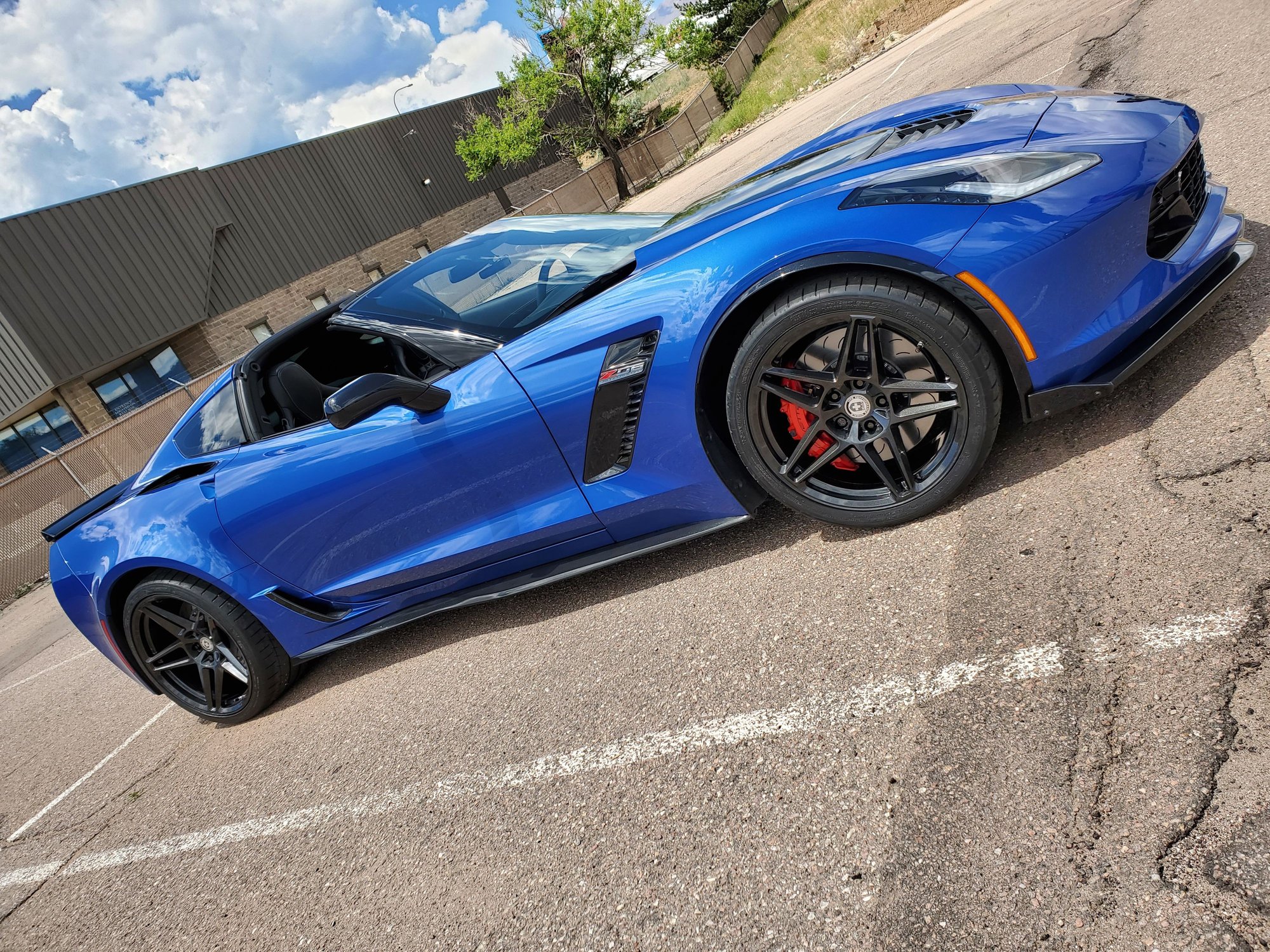

I had mine done in Carbon Flash, to match the rest of the car's trim. No problems so far.
As others said, make sure you deal with a shop that knows what they're doing.

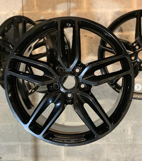

I had my wheels powder coated a year ago. No problems !!! A dumped the Rock Throwing Michelin Pilot Sport tires for A/S 3+ ZP Tires.
Old Apr 3, 2021 | 08:58 AM
Dt86's Avatar
Dt86
Joined: Jan 2014
Posts: 4,017
Likes: 492
From: Poughkeepsie New York
Those look fantastic. Who’d you have do them?

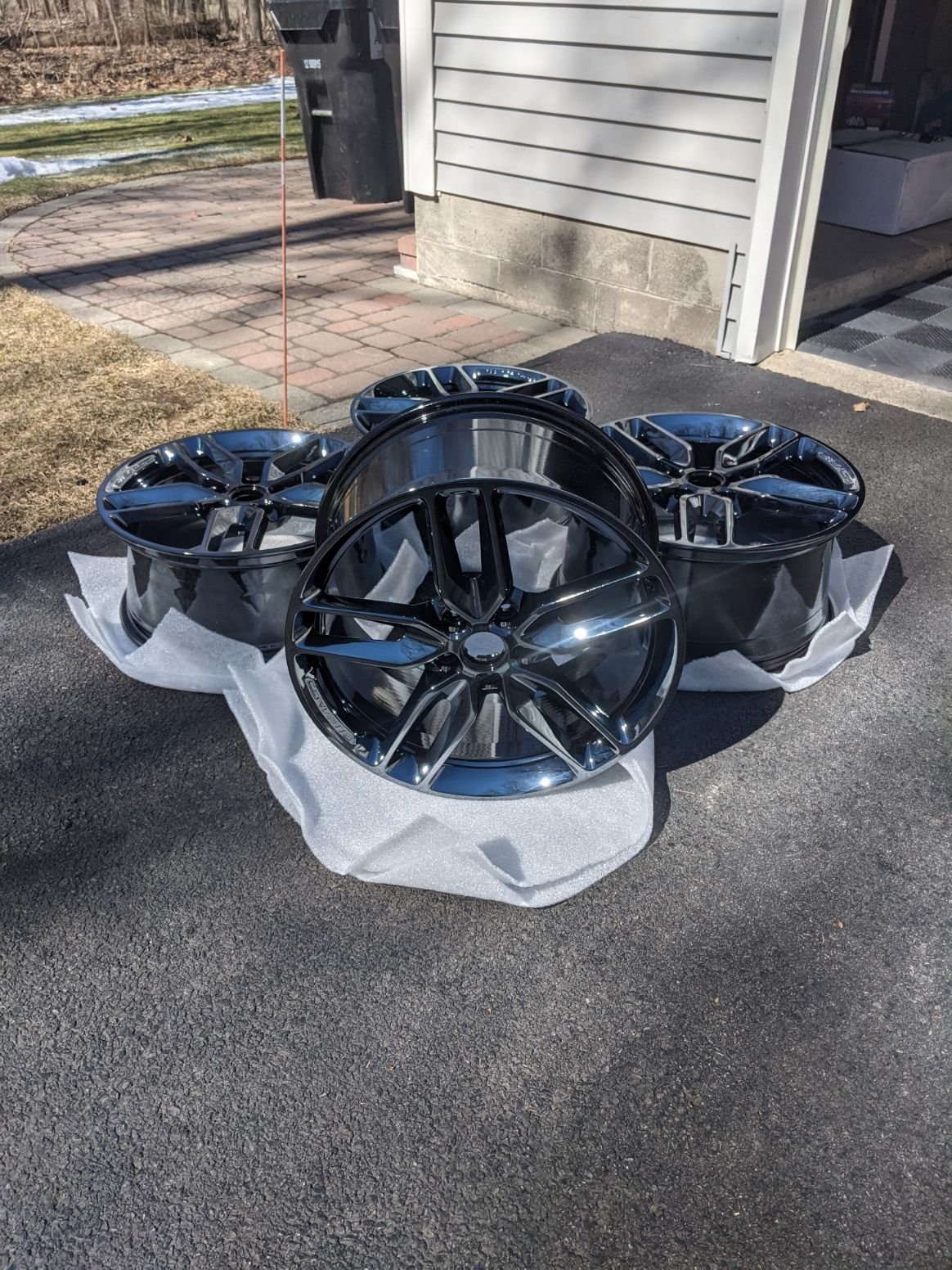

I just had my factory Z51 black wheels refinished. They had lots of pits from brake dust and a little curb rash from the previous owner. I got a local powder coat price of $650 for all four wheels if I used one of their stock colors. It was an additional $25 per wheel for all other colors. I wanted something a little different so I contacted Wheel Craft about having a PVD finish done. They have 4 finishes Bright Ice (Chrome), Black Ice (dark chrome), Midnight Ice (looks like a very glossy black) and black matte. After some research it appears that the PVD finish is somewhat more durable than powder coating. Wheel Craft warranties their finishes for 5 years. They told me that they cure the wheels at 400F which is safe for alloy wheels. These guys know what they are doing because they do the Black Ice finish for one of the large forged wheel manufacturers. Their price was $799 plus shipping. They made the shipping super simple by sending boxes and labels. Total cost was under $1k. Their website is Wheel Craft where you can see the different finishes on their Gallery page. They had the best customer service I have ever experienced. PM me if you want and additional details or contact info for the guy I worked with.
Removed the cover for pictures but haven't taken it out of storage yet. They should look much better in the sun.

George_L, Those look amazing! Is that the Black Ice or Midnight Ice? Very unique finish .
Old Apr 3, 2021 | 07:04 PM
George_L's Avatar
George_L
Joined: Apr 2018
Posts: 1,321
Likes: 927
From: Burnt Hills NY
Wheel Craft developed a special finish for me that falls between Black Ice and Midnight Ice. They even put the finish on a wheel they had and shipped it to me with a return label so I could see it in person before I ordered. I like black wheels but I felt the detail of the wheel was lost from a distance so this finish is perfect for me. If you are interested PM me and I can give you contact information for the person I worked with and the finish name.
