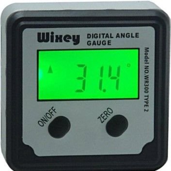

The shop will need this tool and a angle gauge to adjust rear caster.
