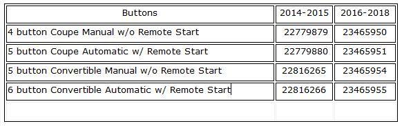

I bought a spare fob on the internet from a dealer parts store. You might also check the C7 parts for sale forum.
Note that you need the correct key fob. 2014/15 are not compatible with 2016/19.
Additionally, the number and function of the buttons must match:
There is NO programming in the fob. All programming is done on the car per instructions above. Think of it like pairing a bluetooth device, but maybe a bit more secure.
