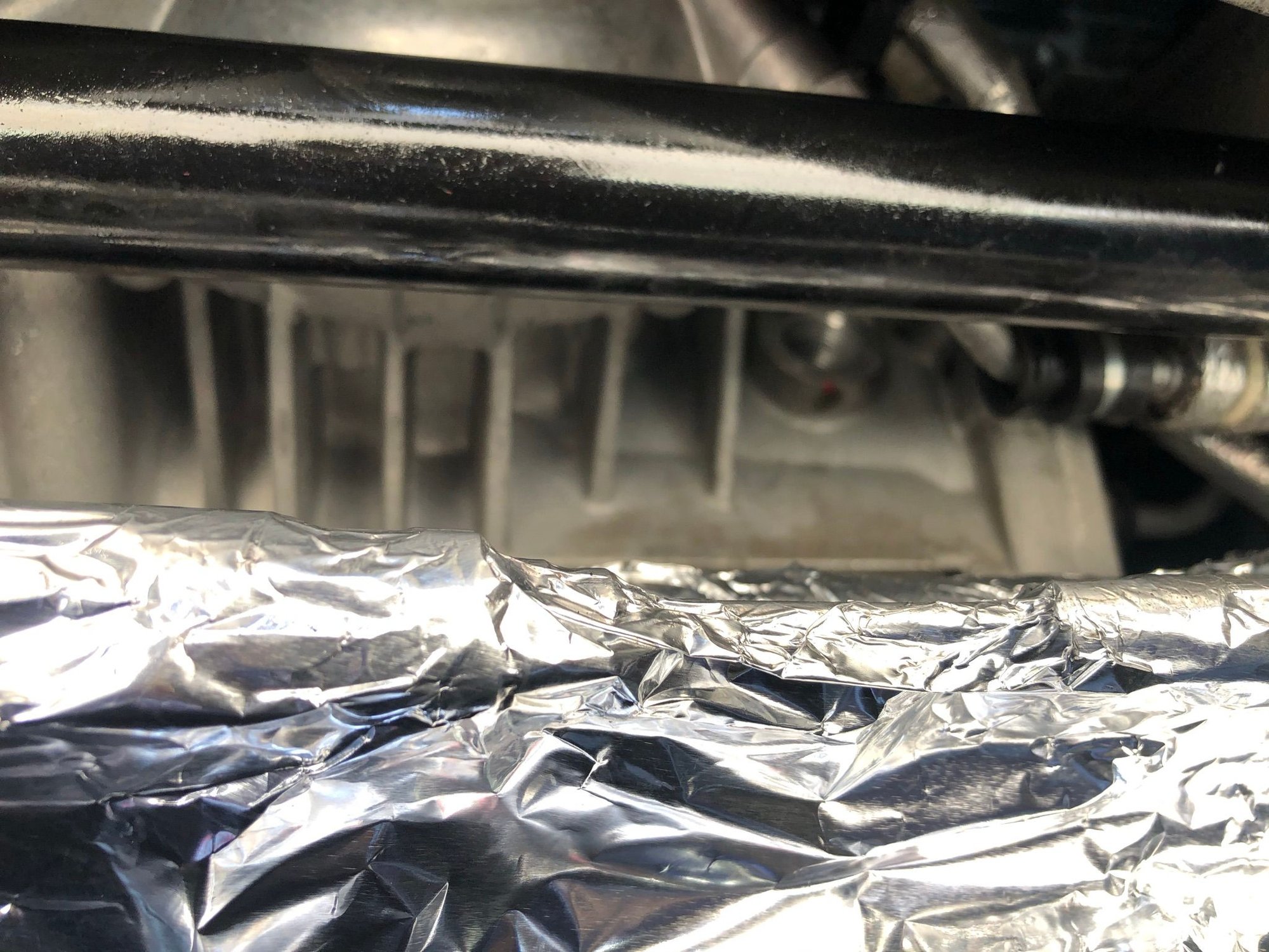

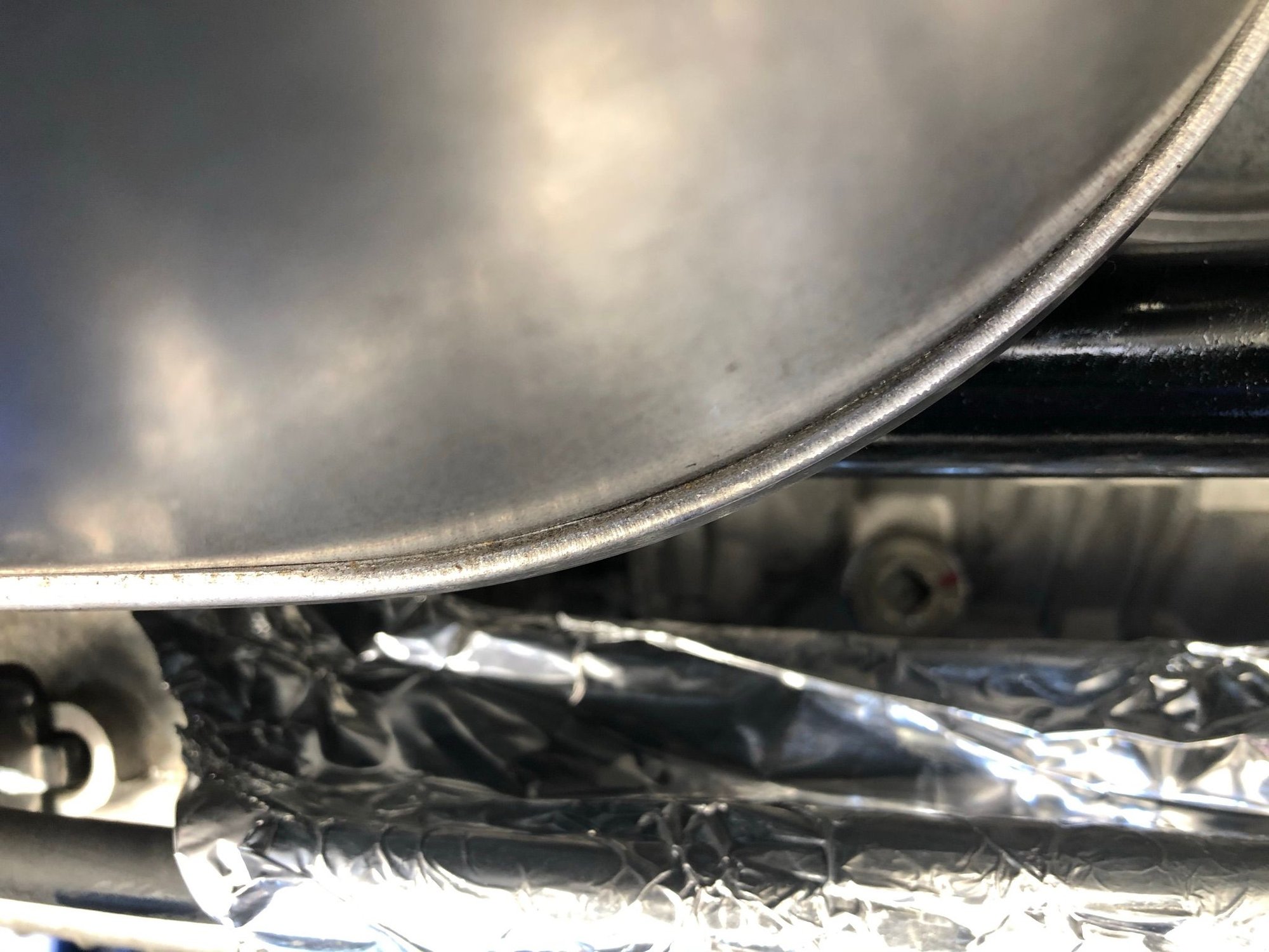

75W-140 didn't cause the failure. It's simply a bit thicker when cold but at the same time offers more protection than 75W-90. If you said they put ATF in the differential rather than gear lube, then maybe. I realize everyone thinks these cars need to be treated like a fine swiss watch and they're as fragile as an egg, but both assumptions are 100% false. I used to run 75W-140 in my C6 on the track and while I haven't switched the C7 over....in fact I just filled with fresh 75W-90 since I was at 25 hours of use....I wouldn't think twice about it.
Fill Plug & Drain Plug
Obligatory track play-day photo
There's more to this story.
