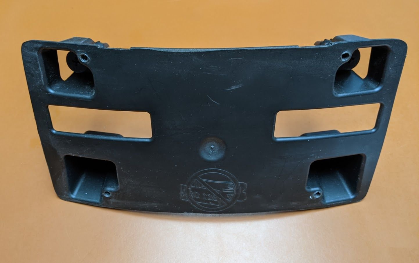

Hello all!
I really want to avoid drilling into the nose of my Corvette, however, my state requires a front plate (New York). That being said, I purchased this front plate bracke ( https://www.gscreations.com/c7-corve...ing-frame-kit/ ) and it finally arrived. The problem is that there's no way to attach the plate to it when you take the CORVETTE front plate piece off.
There's also an illustration which shows that it alone is not intended for mounting of the plate. It looks like I am missing a piece and I can't figure out what it is. Anyone else with this bracket (or in general) have any idea? Thanks in advance!

That is generally known as the "aeroplate". Take off the front piece (embossed with the word Corvette), behind that piece you should see some large phillips screwdriver slots. Back those out and insert the protrusions on the back into your grille. Now tighten the phillips screwdriver slots to expand the protrusions and grip behind your grille.
There are probably some indentations or dimples in the face of the bracket. You will probably need to drill some small holes for your license plate screws. Use the license plate to line-up the holes.
Drill these holes before you mount the bracket to the grille!
Yes! You're right! Thank you very much and to you too, duck!
