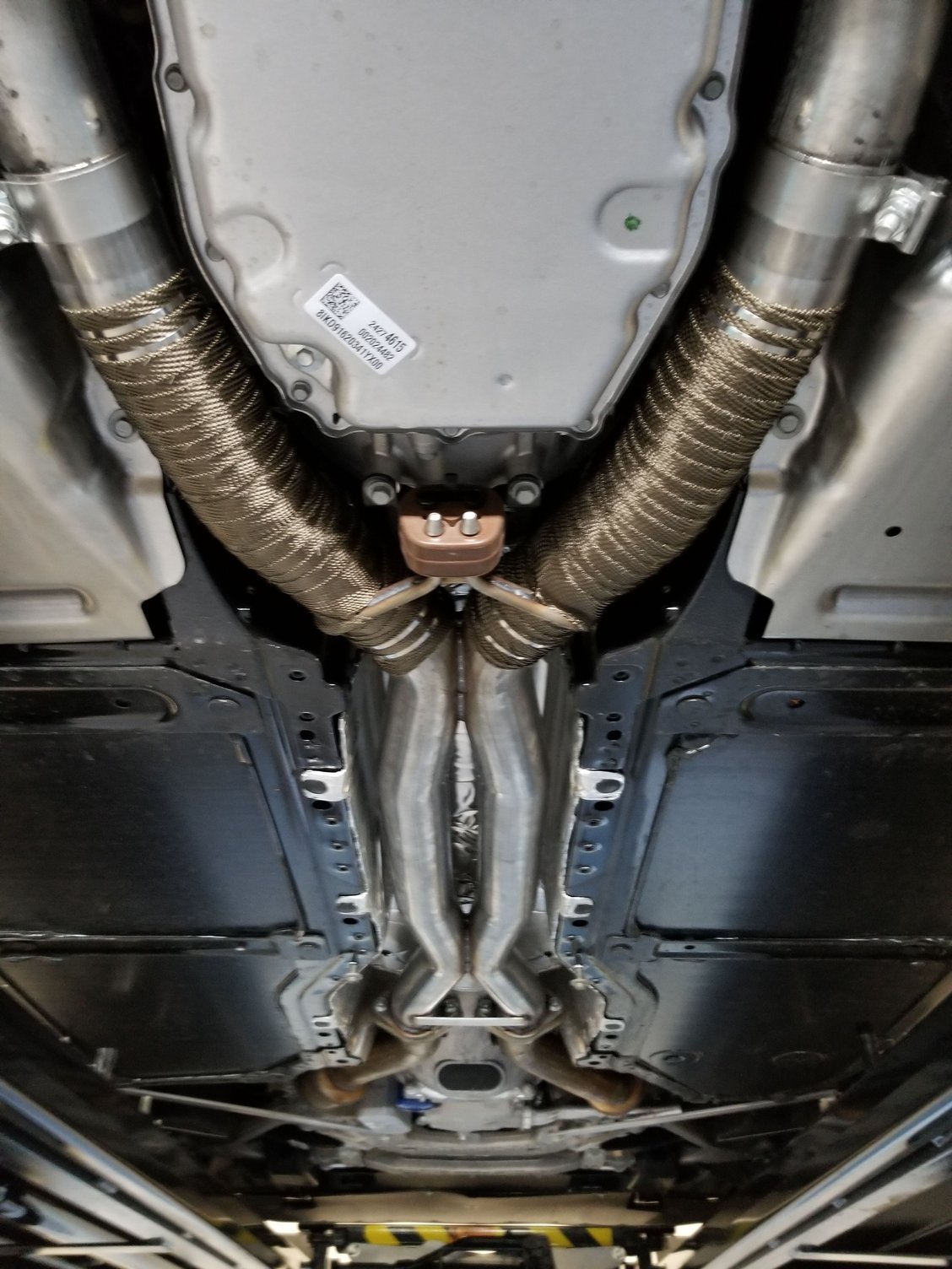

Not sure if you have an A8 but if you're concerned about keeping it a little cooler you can wrap the back of the x-pipes that go on each side of the trans. Did this on my '19 Z and keeps temps down even when flogging it at the track. I'm waiting for an AWE axle-back and when it arrives I'll wrap that from the x-pipe joint back past the trans as well
