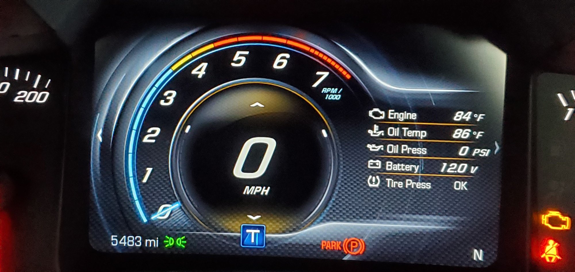

The analog temp gauge on the 2014 is not accurate. It is really just 3 positions - cold, normal, and hot. There is an accurate digital display in the TOUR / PERF display.
Lots of discussion on this back in 2014...
Ron

As @RonC7 said this a "bug" with the analog display on the 2014 - the real temp as shown by the digital readout (and confirmed by a OBD-II reader) will be about 20-30 degrees cooler. So 220 on a 2014 is really about 190-200 and perfectly normal.
