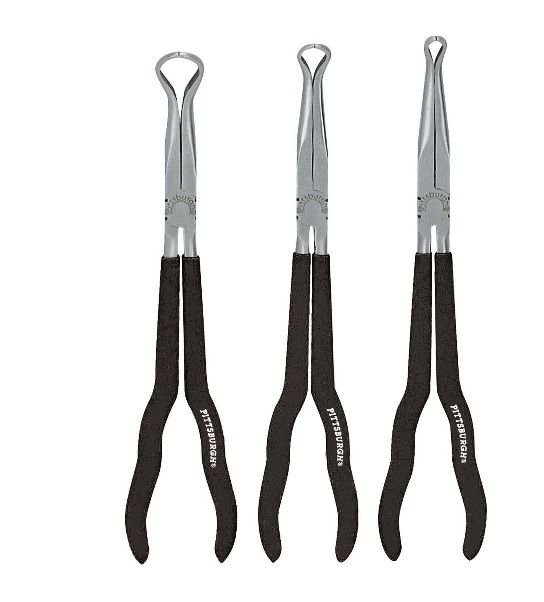

Default angled hose pliers
I agree 100% with Flame-Red.
He has a lot of info on the subject and how-to's.
I had no problems with my 2017 but changed the fluid twice, myself. I could have had it done but don't want a service report saying my car had a shudder problem when it didn't.
FYI: I bought angle hose pliers at harbor freight that helps getting the plug out and then back in.

I've also changed the fluid several times on my C6 and modified HF 80 degree long nose pliers to fit and pull/replace the plug. Then siphon out as much of the fluid as possible before pulling the pan.
