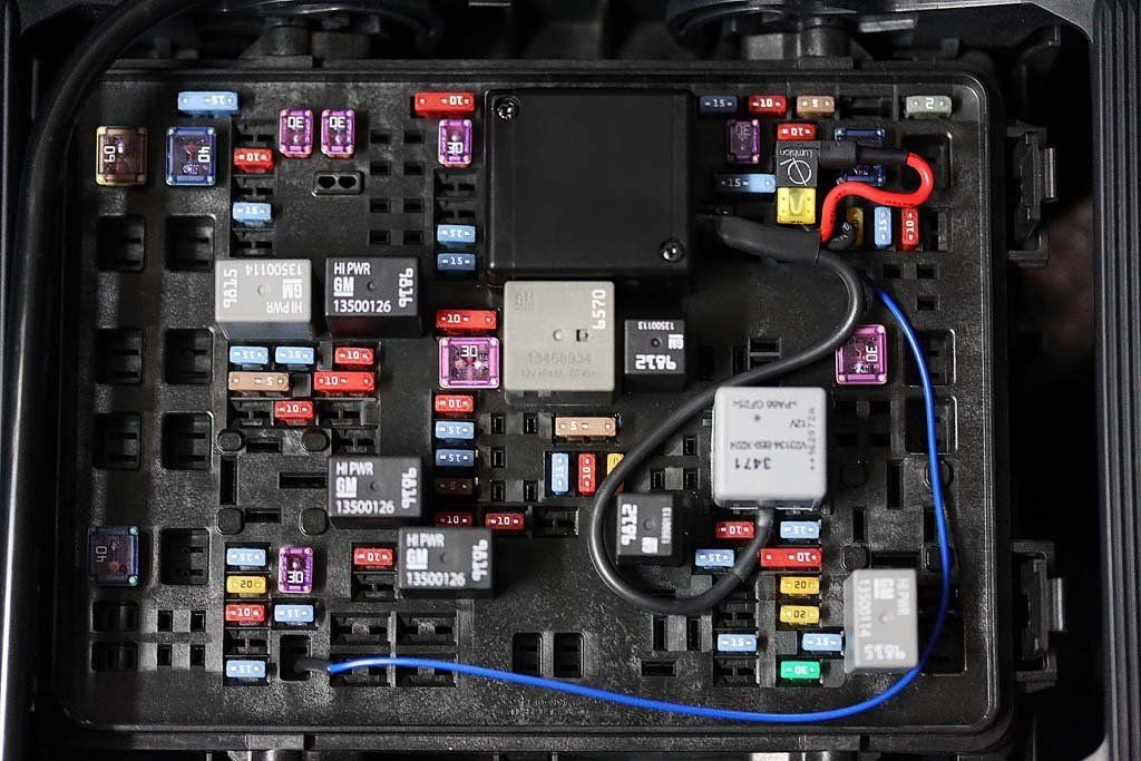

Save time money, and no cutting or modding anything on the car, no cutting access or taping a unit somewhere under hood hiding wires. Follow this post. I did mine recently, love it. Totally concealed under front fuse box, removeable and works through my homelink buttons. Guys on here did a great job figuring this out.
https://www.corvetteforum.com/forums...ob-how-to.html
