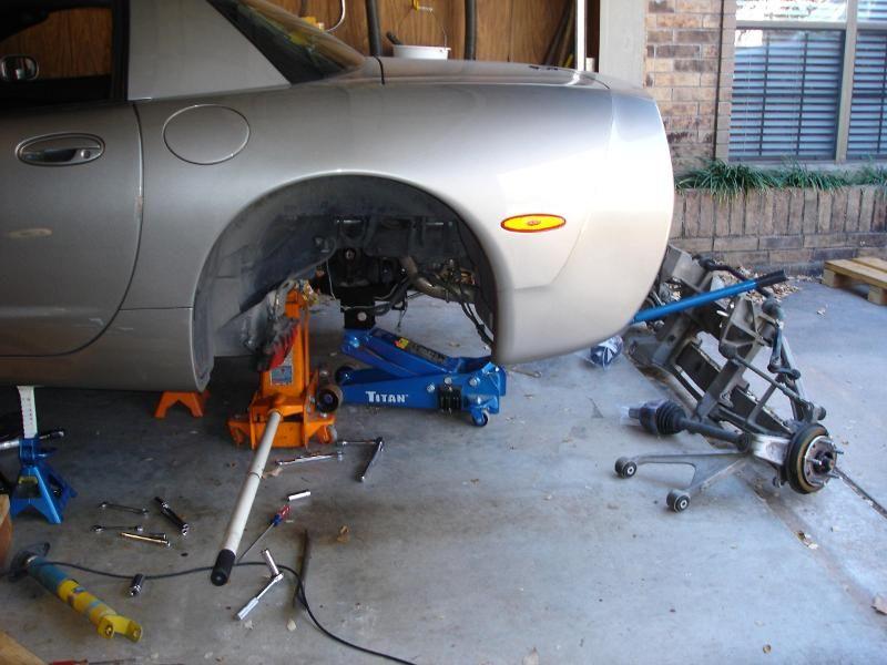

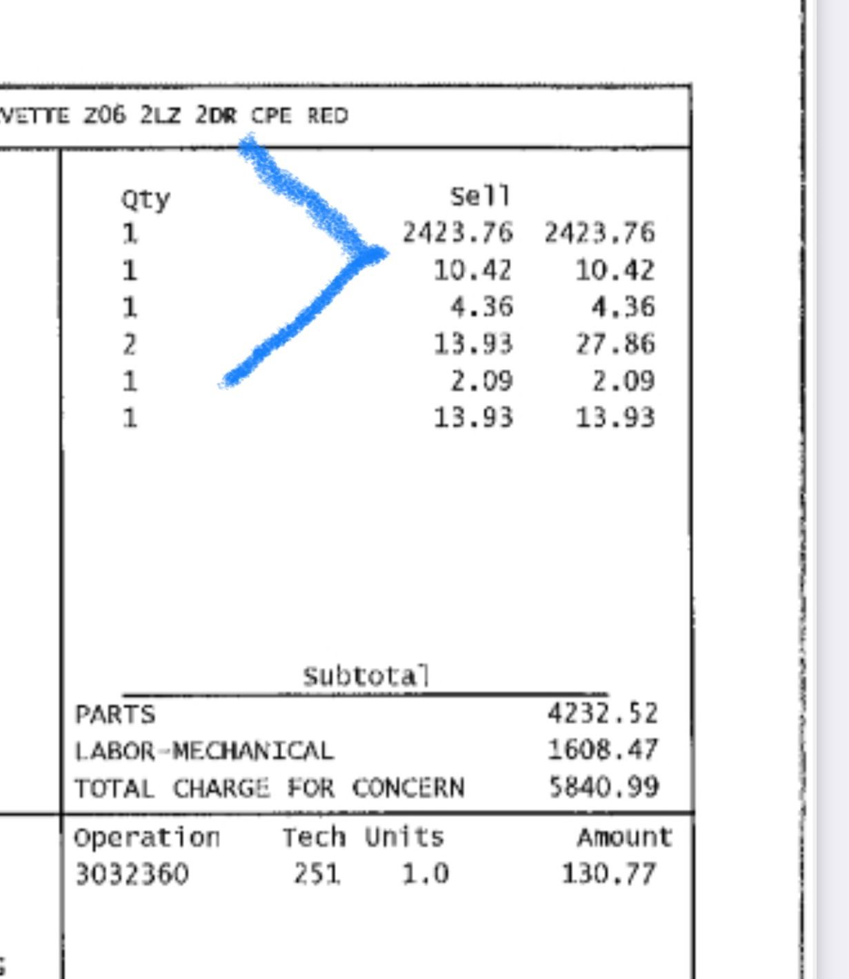

Had my entire torque tube (support member) replaced under warranty on my ‘17 M7 due to a failed clutch pilot bearing. Below is the paperwork showing prices but I get the feeling this number is funny money. $2423 is what they claim for the tube assembly itself. . The labor numbers on all the pages not shown are not easily interpreted.
In terms of complexity the rear cradle comes out too (pic from back in the day when I did this stuff at home on my 2000. uugghhh

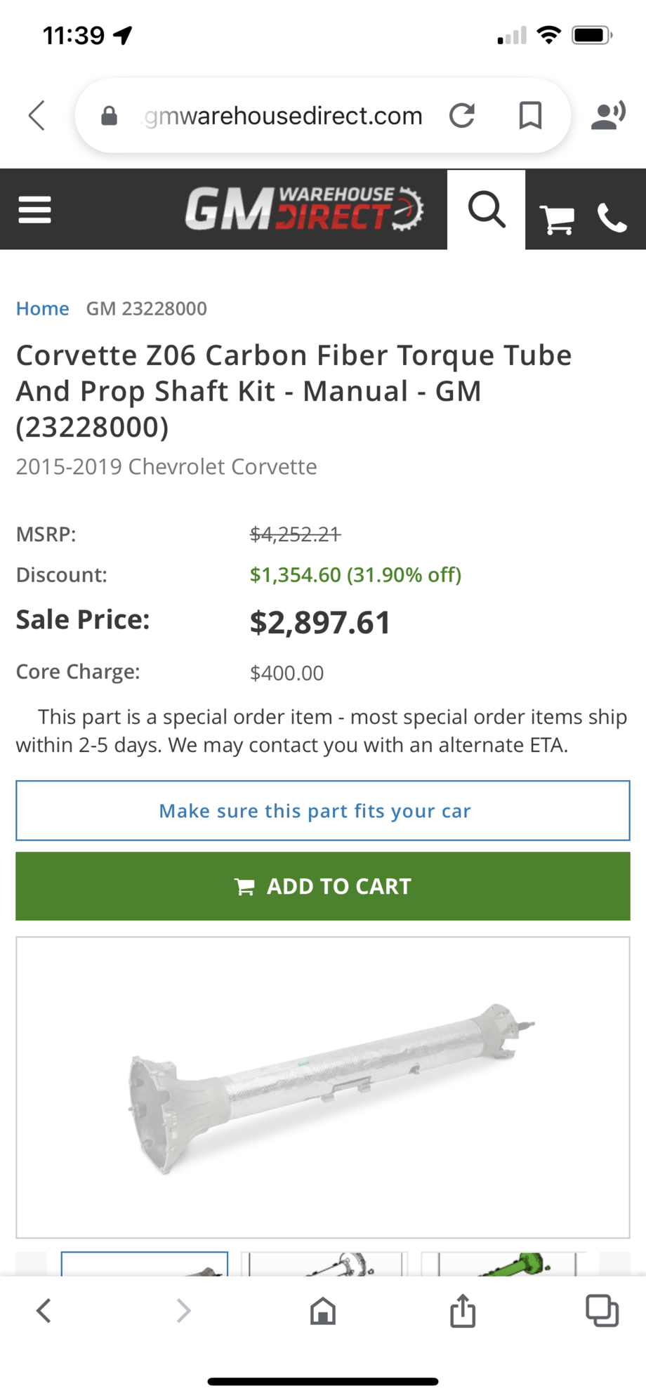

As of now:
C7 Corvette Stingray/Z06/Grand Sport 2014-2019 GM Carbon Fiber Torque Tube & Prop Shaft Kit
Part Number: 13547
Limited Time Promo $4,099.99 $3,699.99

I believe this is the p/n the dealer used when replacing mine.
To Torque Tube Replacement
Wow that looks like a huge job! I do my own mechanic but nowadays I'm so busy with work this type of job I would ask a reputable Lexus dealer to try and replace it for me.
