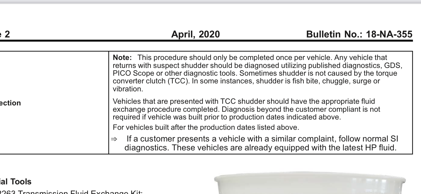

I just got back from the dealership after showing them the service bulletin and pointed out where it says no diagnosis beyond my complaint. They pulled the same service bulletin on their computer but want to call GM !

Time for you to go see the service manager or the general manager. The TSB does not say they have to confirm it. I believe it is TSB-18-355 dated April 2020
I don't know if I want to get in a PI$$ING contest with my dealer . Not that they would do anything shady with my car but ......

Look for another dealer if this one will not do it. It clearly states done at owner's request, do not have to prove anything or be test driven. When I had mine done, showed the dealership a copy of the TSB and was done no questions asked under powertrain warranty.

You don’t have to get into pissing contest . I would ask to talk to service manager Ask him to read second paragraph in correction area on first page of bulletin. Where it stated no further diagnosis beyond Customer complaint is needed. I talked to my dealer service manager before making a appointment and told him I would like this done under warranty even though my car has no symptoms of shudder. I want correct fluid that GM now recommends in tranny and to prevent possible future problems. If your service manager says no still then as others said go some where else ! Just make sure service manager was reading the latest update to bulletin where it stated no further diagnostic is needed beyond customer request. They may have read a earlier version of bulletin that I don’t believe it stated that.
