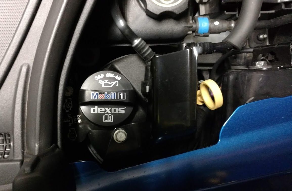

Do you fill the oil into the valve cover or a black tank near the passenger side windshield?
Old Jul 21, 2021 | 09:52 PM
wrecker3's Avatar
wrecker3
Joined: Nov 2003
Posts: 2,849
Likes: 1,867
From: NEW WINDSOR NY
Dry Sump Tank.

u either have a dry sump at top passengers side engine bay area to fill (9.8 quarts) or you fill up at the valve cover area of engine and use 7 quarts i believe.
Old Jul 22, 2021 | 08:50 AM
eboggs_jkvl's Avatar
eboggs_jkvl
Moderator emeritus
Joined: Jun 2001
Posts: 18,599
Likes: 3,951
2015 C7 of the Year Finalist
RPO code on my 2014 is:
Z51 Z51 Performance Package
Z52 Dry sump oil system

Grandsports and Z06 also have Dry sumps, only base Stingray (non-Z51s) take 7.0 quarts. As demonstrated above, it's VERY easy to distinguish between the wet and dry sumps C7s.
