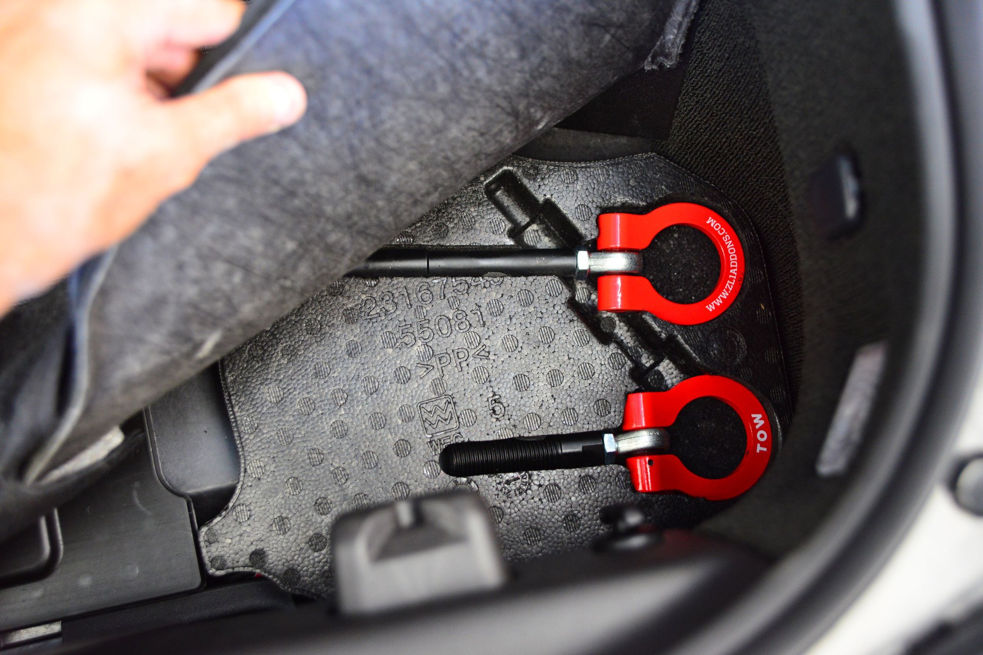

I have the Corvette 14-19 Premium Tow Hook ZL1 Add Ons. Good quality. They work and you can modify foam a little to keep them in car. If you buy cheepo unbranded ones on eBay or Amazon.. you get what you pay for is all I can say.
I have the same one. Appears to be excellent quality, and HEAVY! What's the short one for?
Old Aug 17, 2021 | 10:00 PM
NortonCO's Avatar
NortonCO
Joined: Sep 2019
Posts: 1,898
Likes: 1,923
From: Colo Spgs, CO
The "long" tow hook is designed for the front, but can be used front or rear, while the "short" one is designed for the rear and can only be used there.

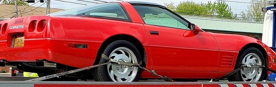

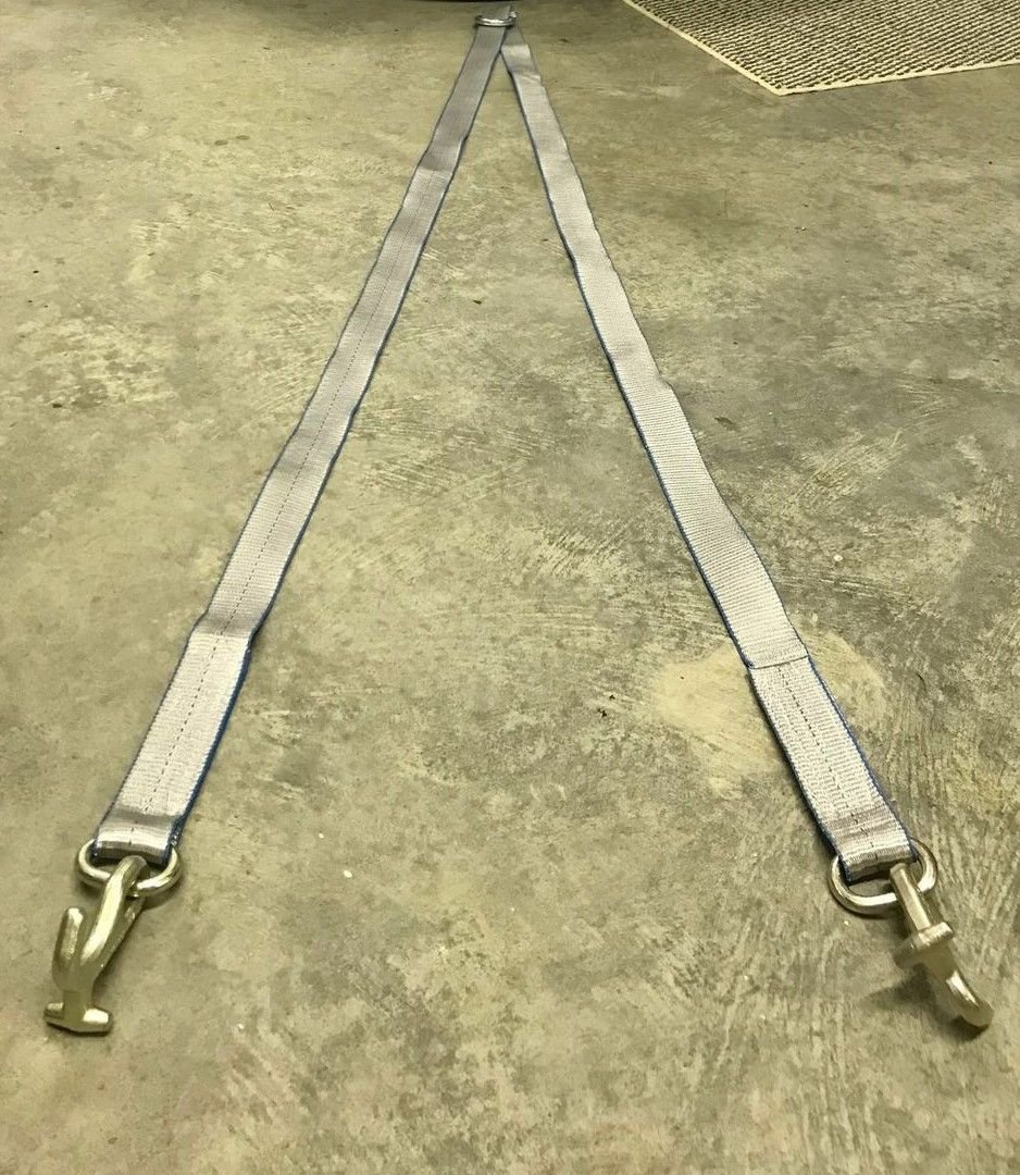

Using the tow hook to load a C7 on a flatbed will pull your car to the left and put stress on the hook. It is better to use a tow strap that has T-Hooks using the T-Hook slots (where you put the lifting pucks) and will winch your car straight up the bed. and then use over the wheel to tie it down.
Not to hijack this thread, but what did you use to cut out/shape foam - looks like a nice clean job? I have same tow hooks and had thought abought this, but haven't had good results cutting molded foam in past. Thanks.
I bought this bridal also. I just keep it in the cubby in the hatch area just in case.
