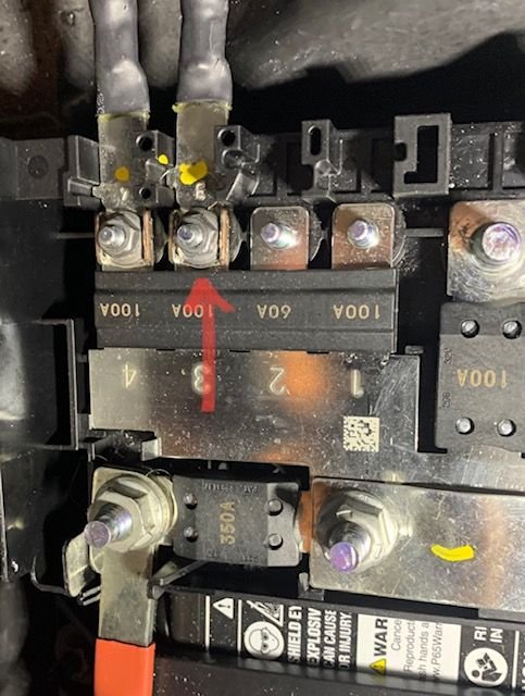

Check and double check all the cable terminals on the battery board. I had similar "service rear axle" and actual sporadic engine flame outs. Found one of the 100 amp terminals just a tad loose and it would apparently lose contact now and then, like twice a week or so, and give me these issues. The one indicated by the red arrow was the problem. Snugged it up and all is well.
