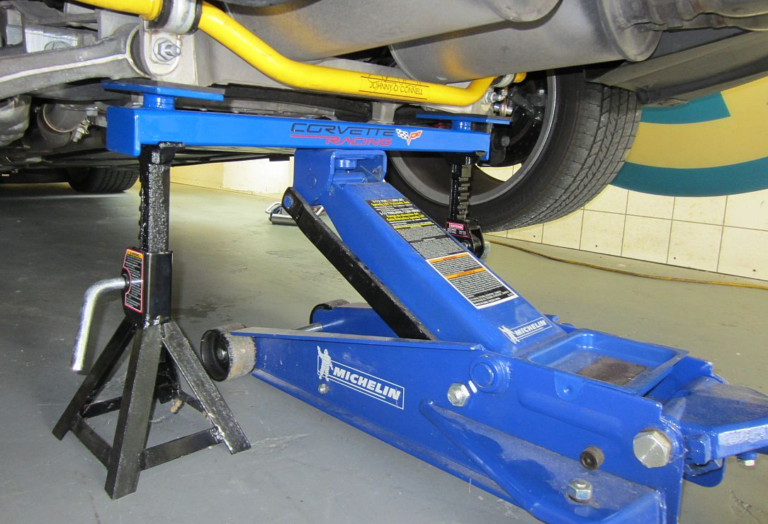

Greetings! I was wondering if you could help me with this process, and I want to do it safely.
I have a Stingray that I have added the ACS zo6 style splitter and rockers
I like the idea of getting a low-profile jack, with one of the cross members. I saw a picture of one of these here on CF.
I want to jack up the front in one shot, and then place the tires in wheel cribs. Then, move to the back and jack up the rear in one shot. Placing the rear wheels in wheel cribs.
I don't think I would be able to get a low-profile jack all the way to the front jacking point. I was thinking I could use a small ramp. How much height would I need from a ramp to get a jack far enough in to do this? Would 2 - 2.5", would that be adequate?
How does this plan sound? What am I not considering? Thanks!
(picture below for reference, but not my picture)

I use two jacks at the front puck locations (drivers and passenger side) because reaching the cradle position up front is basically impossible unless you have a really long low jack. My method requires going slowly to keep the vehicle even / level side-to-side but it works for me. Depending on height of the wheel cribs just doing each corner individually can work because the car never gets so high that you are dealing with extreme angles.

I Jack up from the front puck high enough to place a 2 by 10 inch board under the front and back tires. Then do the same on the other side. Once the car is elevated on the board you will be able to reach the front jacking position. Place the cradles under the front wheels. Then Jack from the rear. Be careful the car is not on any incline.

Buy a 2 x 8 - cut two pieces 30" long and two pieces 24" long. Now cut a 45 degree bevel on one end of each piece. Stack the 24" on top of the 30", even at the square end, and screw them together. Cut two 3"-4" pieces and screw them on top of the 24", again even with the square end, to act as a stop. Slowly drive the front tires onto this homemade ramp and you are now high enough to get your low profil jack under the front of the Corvette.

You are going to have to get the front end up in the air a bit, whether that be by ramps or just jacking up each side, in order to get a floor jack in far enough to lift the car from the front crossmember. The car just sits too low to do so otherwise.

The front is the tough end. If I run the tires up onto 2x10s I can barely get a jack in far enough. A longer jack would make it easier but from everything I have seen about jack points, you don't want to jack in the center of the subframe w/o something like you pictured at the rear. (It is aluminum and it is hollow and not real thick. I almost wish mine were steel because jacking this car is the biggest pain of all the cars I have ever owned.) So for that, you need more height. I do the same as JMII. 2 jacks, one at each front puck point. And then a 2x6 and another jack to the subframe. Yep, that is 3 jacks. I have one older aluminum standard sized jack and 2 of the HF small aluminum jacks. And you have to be careful you don't take the front too high, or you won't be able to get under the rear. I think duckvett has a good idea w/ the double thickness 2x10s. I have several single 2x10s and think about building like he suggests. What keeps me from doing that is that all my 2x10s have various amounts of splitting, and some have had to be trashed. So I have been waiting for plywood stuff to drop price and think I will make the equivalent of the double 2x10s but from something that doesn't warp and then split when driven on.
