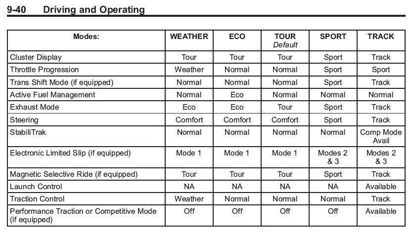

For the OP here are the drive modes and what changes with each:

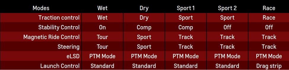

And here are the Performance Traction Modes or PTM that become available once you select Track Mode and double tap the traction button to access the sub modes:
