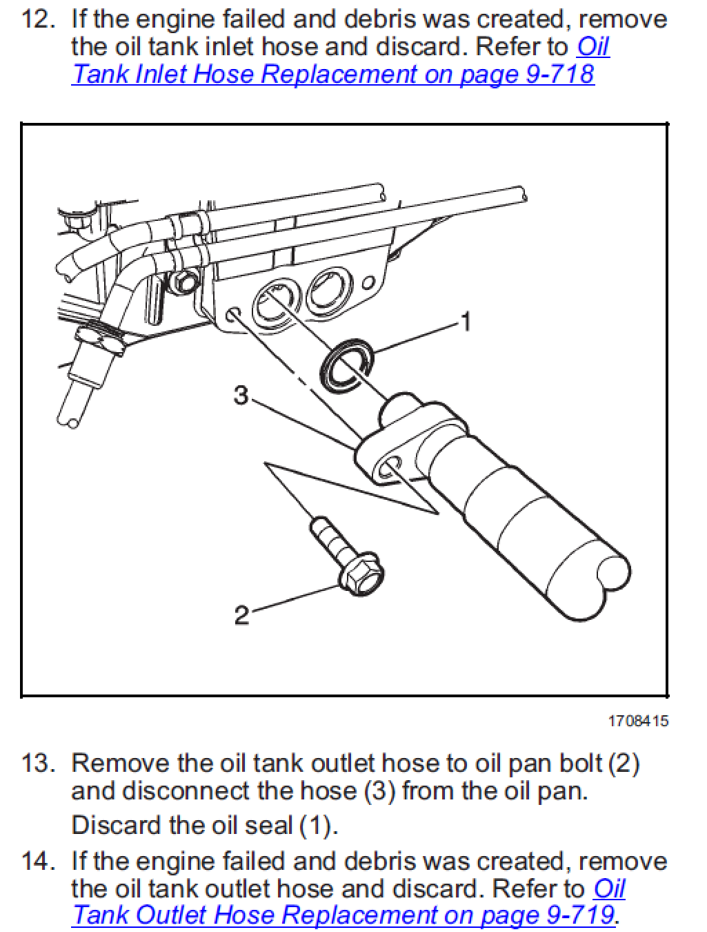

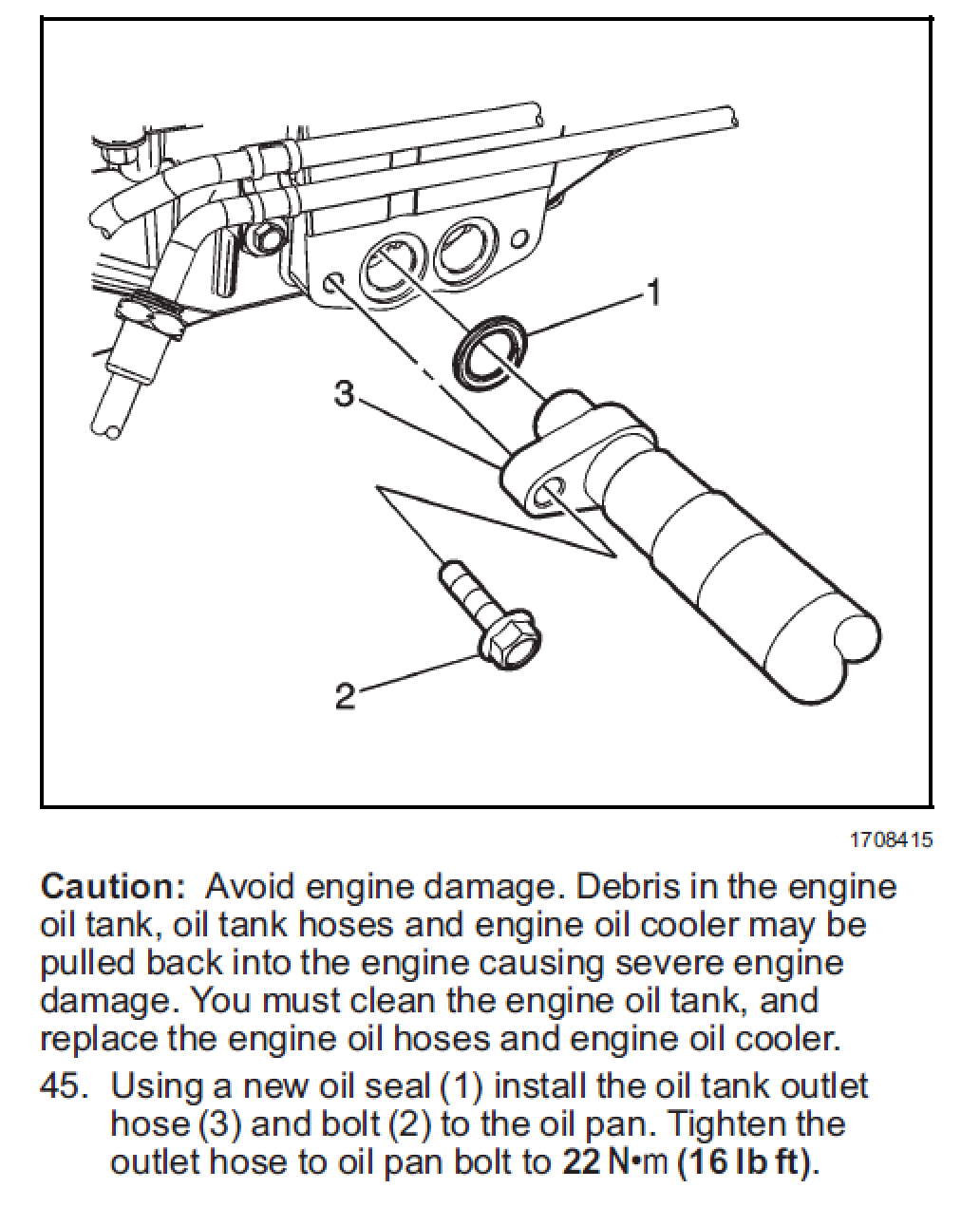

You need to disassemble and clean the dry sump, discard hoses and the oil cooler. Here are some snapshots I made from the FSM engine replacement procedure:
Hope this helps.
Bill
