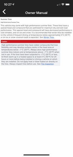

2018 Owners Manual:

As others stated, GM & Michelin tell you to not drive or move the factory PSS tires in temps below 20'F, to prevent possible cracking. Some people have gotten away with it, others had to get out their wallet.

I wouldn't worry about it with the PSS ZP. If you have the PSS Cup2 tires you don't want to use or store them in temps below 20 degrees. The difference between the two is the PSS ZP is a full-fledged street tire (although a summer tire) while the Cup2 tire is truly a DOT R compound competition tire that is barely street legal and falls into the same category as the Hoosier A and R7 tires, Toyo R888 and others. The Cup2s have been known to suffer tread cracking when exposed to temps below 20 degrees. I have never seen reports of any issues with the PSS ZPs suffering any ill effects due to cold weather operation. Yes, it takes more skill to drive with them than it does a set of All Seasons due to having less grip in cold weather but that shouldn't be a big issue for drivers willing to learn how to use the throttle pedal properly.
